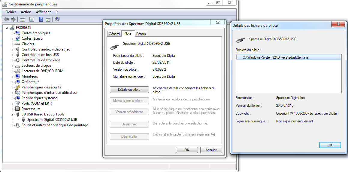

Debuger : XDS560 STM (spectrum digital)
hi I am Graduate student.
I design digital board and it's MCU is TM4C1292NCPDT
i want test board design is right, so I need JTAG. my lab have XDS560 STM, i want use it.
but it is not work. error message is like this.

and i think it may be reason why it is not work.
it is my setting
how can I XDS560 is work?
