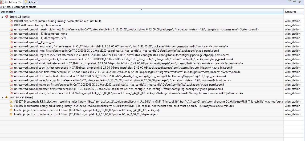

  • I reinstalled CCS and set the ti_rtos_config properties appropriately.  After following the specified compile order, I was able to get successful builds on everything except for wlan_station, which gave a slew of error and warning messages regarding unresolved symbols as follows (see below).  It seems as though a critical library is not being properly referenced.  I would appreciate any suggestions
    unresolved symbol memset, first referenced in C:\ti\CC3200SDK_1.0.0\cc3200-sdk\ti_rtos\ti_rtos_config\ccs\Default\configPkg\package\cfg\app_pem4.oem4 wlan_station    C/C++ Problem
    unresolved symbol memcpy, first referenced in C:\ti\CC3200SDK_1.0.0\cc3200-sdk\ti_rtos\ti_rtos_config\ccs\Default\configPkg\package\cfg\app_pem4.oem4 wlan_station    C/C++ Problem
    unresolved symbol main_func_sp, first referenced in C:\ti\tirtos_simplelink_2_01_00_03\products\bios_6_40_03_39\packages\ti\targets\arm\rtsarm\lib\boot.aem4<boot.oem4> wlan_station    C/C++ Problem
    unresolved symbol exit, first referenced in C:\ti\tirtos_simplelink_2_01_00_03\products\bios_6_40_03_39\packages\ti\targets\arm\rtsarm\lib\ti.targets.arm.rtsarm.aem4<System.oem4> wlan_station    C/C++ Problem
    unresolved symbol copy_in, first referenced in C:\ti\tirtos_simplelink_2_01_00_03\products\bios_6_40_03_39\packages\ti\targets\arm\rtsarm\lib\auto_init.aem4<auto_init.oem4> wlan_station    C/C++ Problem
    unresolved symbol abort, first referenced in C:\ti\tirtos_simplelink_2_01_00_03\products\bios_6_40_03_39\packages\ti\targets\arm\rtsarm\lib\ti.targets.arm.rtsarm.aem4<System.oem4> wlan_station    C/C++ Problem
    unresolved symbol _register_unlock, first referenced in C:\ti\CC3200SDK_1.0.0\cc3200-sdk\ti_rtos\ti_rtos_config\ccs\Default\configPkg\package\cfg\app_pem4.oem4 wlan_station    C/C++ Problem
    unresolved symbol _register_lock, first referenced in C:\ti\CC3200SDK_1.0.0\cc3200-sdk\ti_rtos\ti_rtos_config\ccs\Default\configPkg\package\cfg\app_pem4.oem4 wlan_station    C/C++ Problem
    #10010 errors encountered during linking; "wlan_station.out" not built wlan_station    C/C++ Problem
    <a href="file:/c:/ti/ccsv6/tools/compiler/dmed/HTML/10234.html">#10234-D</a>  unresolved symbols remain wlan_station    C/C++ Problem
    unresolved symbol strlen, first referenced in C:\ti\tirtos_simplelink_2_01_00_03\products\bios_6_40_03_39\packages\ti\targets\arm\rtsarm\lib\ti.targets.arm.rtsarm.aem4<System.oem4> wlan_station    C/C++ Problem
    #10366-D automatic library build: using library "c:\ti\ccsv6\tools\compiler\arm_5.1.8\lib\rtsv7M4_T_le_eabi.lib" for the first time, so it must be built.  This may take a few minutes. wlan_station    C/C++ Problem
    unresolved symbol _args_main, first referenced in C:\ti\tirtos_simplelink_2_01_00_03\products\bios_6_40_03_39\packages\ti\targets\arm\rtsarm\lib\boot.aem4<boot.oem4> wlan_station    C/C++ Problem
    unresolved symbol _nop, first referenced in C:\ti\CC3200SDK_1.0.0\cc3200-sdk\ti_rtos\ti_rtos_config\ccs\Default\configPkg\package\cfg\app_pem4.oem4 wlan_station    C/C++ Problem
    unresolved symbol __TI_zero_init wlan_station    C/C++ Problem
    unresolved symbol __aeabi_uidivmod, first referenced in C:\ti\tirtos_simplelink_2_01_00_03\products\bios_6_40_03_39\packages\ti\targets\arm\rtsarm\lib\ti.targets.arm.rtsarm.aem4<System.oem4> wlan_station    C/C++ Problem
    unresolved symbol __TI_decompress_none wlan_station    C/C++ Problem
    unresolved symbol __TI_decompress_rle24 wlan_station    C/C++ Problem
    #10207-D automatic RTS selection:  resolving index library "libc.a" to "c:\ti\ccsv6\tools\compiler\arm_5.1.8\lib\rtsv7M4_T_le_eabi.lib", but "c:\ti\ccsv6\tools\compiler\arm_5.1.8\lib\rtsv7M4_T_le_eabi.lib" was not found wlan_station    C/C++ Problem
    unresolved symbol HOSTwrite, first referenced in C:\ti\CC3200SDK_1.0.0\cc3200-sdk\ti_rtos\ti_rtos_config\ccs\Default\configPkg\package\cfg\app_pem4.oem4 wlan_station    C/C++ Problem

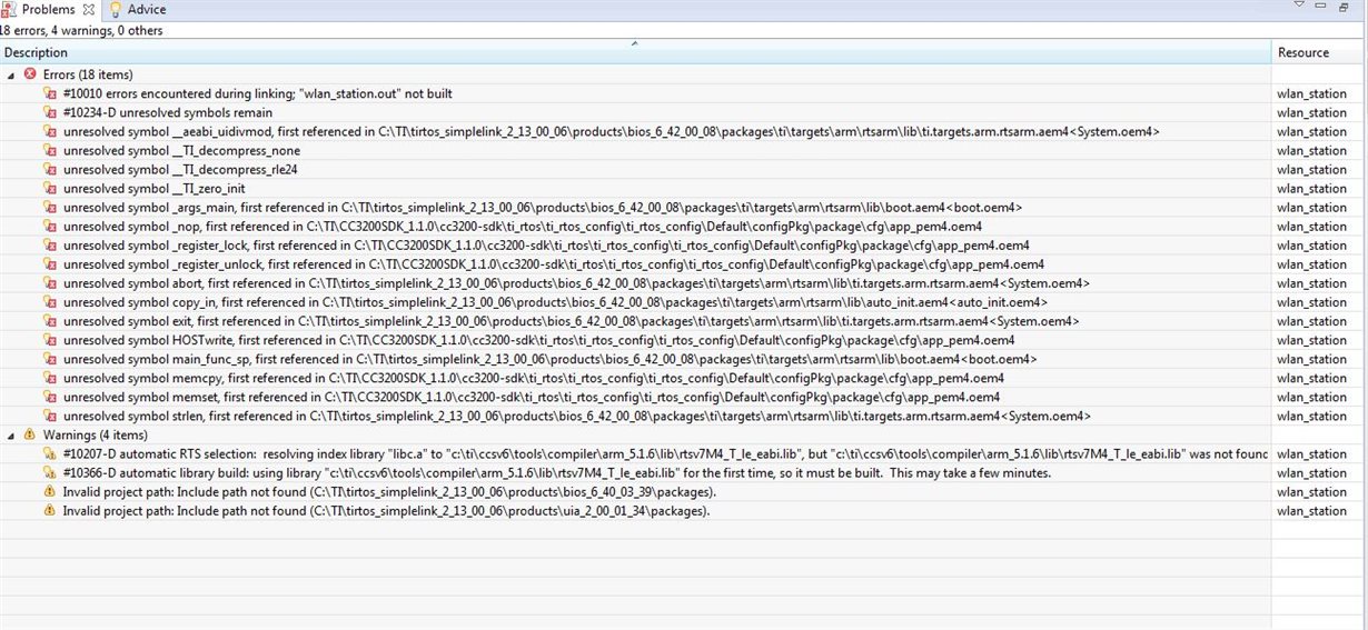

  •  Hi Kel,
    I'm working on cc3200 launch pad. When I compiled oslib project, I'm seeing same errors (which is mentioned by Mike). I have deleted all the imported projects at workspace, Also created newly, still getting same errors. Please suggest if any other problem solving methods.

  • I solved this issue by removing all the files and folders related to previous installations of CCS. I went into C:\users\<username>\Appdata\Local. There are three folders named Local, Local Low and Roaming. I removed all the folders in those names folders under Local. Then I ran a cleanup through CCleaner. Please be advised, clearing the folders Local, Local Low and Roaming means that you clean all the cache that is stored. Then try compiling the rtos configuration files and it should work fine. I did this a windows 10 laptop.
