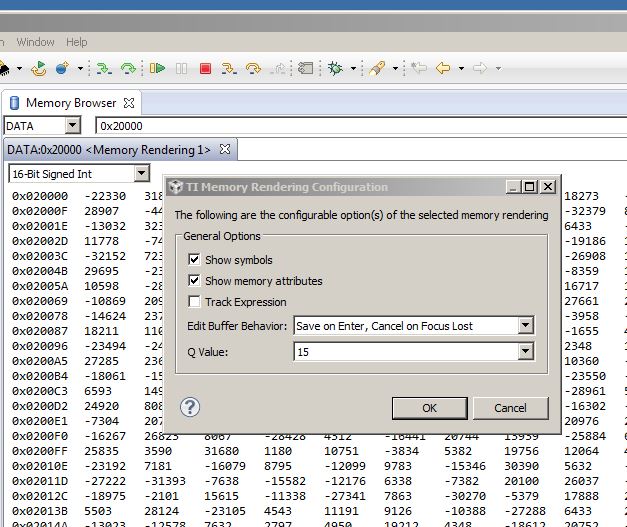

  • AartG,
    You can select 'Q Value' in the context menu 'Configure...' of the Memory Browser. But setting it does not show any effect in the Memory Browser.

  • AartG,
    Just an addition to my previous post. For the Q Value selection to show up in the context menu of the Memory Browser its display format needs to be set to a 16 or 32 bit integer format first. This does make sense.
