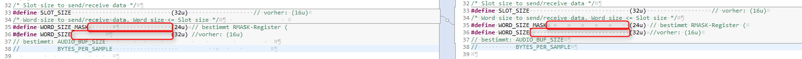

when I edit a file and press Ctrl-Shift-F unintantionally (for Rowley's editor this is the Find command - it's so
difficult to suppress certain habits), the next compilation provides the following errors.
'Invoking: ARM Compiler'
"../mcasp_in.c", line 93: error #20: identifier "AUDIO_BUF_SIZE" is undefined
"../mcasp_in.c", line 119: error #20: identifier "WORD_SIZE" is undefined
"../mcasp_in.c", line 149: error #20: identifier "WORD_SIZE" is undefined
"../mcasp_in.c", line 404: error #20: identifier "MCASP_XSER_RX_SDOUT2" is undefined
The definitions still exist in the source file. Cleanining the project does not solve the problem.
Also, starting CCSv6.01 with the -clean parameter does not help.
But replacing the file leads to a compilation without errors.

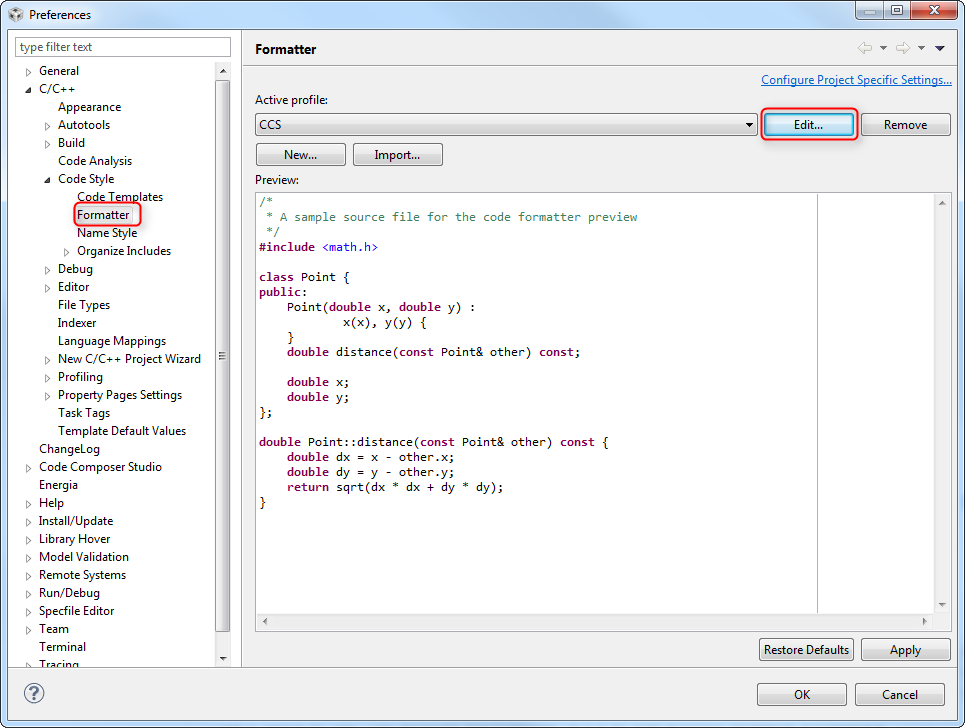

What is Ctrl-Shift-F expected to do? According to the help menu it means "Format".
Is there a "CCS6 Users Guide" downloadable? So far I only found one for CCS5 and a Getting Started document for CCS6.
