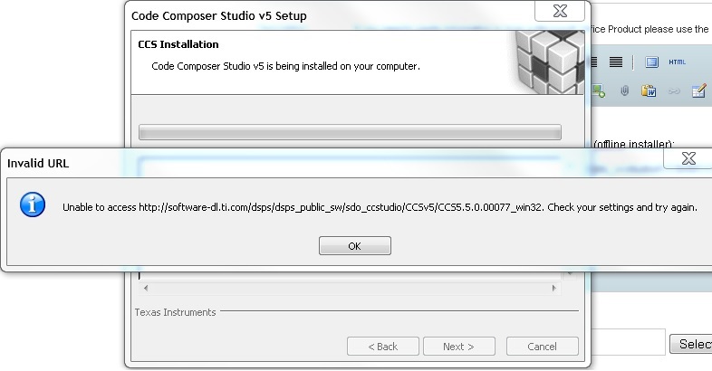

I got the following error message during the installation of CCS5.4 (offline installer) on Windows 7:
"unable to access http://software-dl.ti.com/dpds/dsps_public_sw/sdo_ccstudio/CCSv5/CCS5.5.0.00077_win32. Check your setting and try again"
Same behaviour with online and offline CCS5.5 installer. Firewall is disabled and I have administrator user rights.
Any ideas? Could you check if the server is up?
Thanks for your help.

    Can you please post the installation logs from c:\program files\installjammer registry\ccsv5 (program files (x86) if you're using a 64 bit computer) so I can take a look?
    Please ensure you've unzipped the offline installer correctly, i.e. retaining the folder structure.

    Unfortunatelly I didn't found the installjammer registry folder in program files (x86).
    Nevertheless I extracted again the offline installer package and now I can install it without any issue... I don't really understand what happened but at the end it works so thank you for the suggestion and your support.
