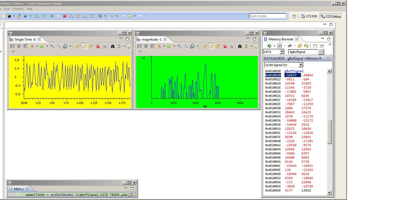

The Time Graph is the only graph that works about right. The FFT Magnitude graph is unusable. Scaling and windowing does not work properly, there is no peak-and-hold feature (very important), a logarithmic vertical axis does not show in dB. There is no Constallation graph and no Eye Diagram graph available at all. What are these people thinking? All this has been available for years and was working beautifully before CCS v4. Do we really have to reinvent the wheel?
The contents of a memory window can not be displayed in fractional integer format (has now been filed as a bug). Considering that this format is the mostly used format when developing fixed-point algorithms and assuming that this bug has been in there since v4 one can only wonder.Looking at the Memory Browser in the picture below, one also sees that the last location shown in the window does not change to red color after its value has changed.

Screen shot of the same debugging session on CCS v6:

    As far as the graphs you are correct that current CCS is lacking when compared to vintage CCS.  There have been some efforts to improve them but they do still fall well short.  I hope that we can make some improvements to close the gap more but I also don't want to over promise.
