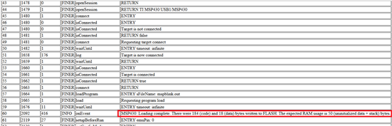

From a DSS Javascript script, I'm trying to capture what I see in the CCS console when the board boots, e.g.:
"MSP430: Loading complete. Code Size - Text: 7052 bytes Data: 26 bytes."
It is possible to capture this from within DSS?  I've tried session.stdOut(), but it returns nothing.  Thanks in advance.
    This message is not from stdout but a message from the debugger. You can increase the console and log verbosity to get this message in the console and logs. When I crack both up to "TraceLevel.ALL" I see the message:
    ki
  • Is there a way I can extract that message from within my DSS script so I can, for example, verify that a certain number of bytes were loaded?
    Looking at the logs, I can see that it's using a DebuggerInfoListener.  Can I register my own DebuggerInfoListener and handle the debug output myself?
