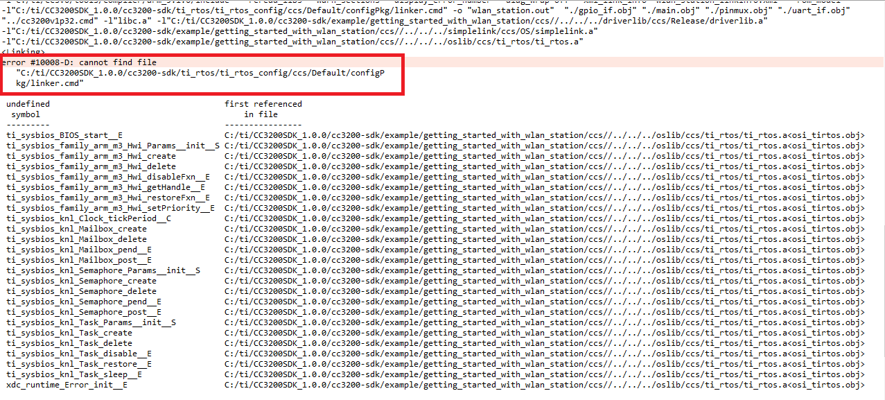

Hi Rob

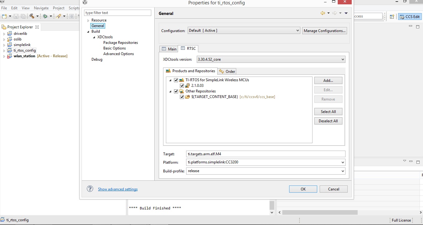

I tried your suggestions but unfortunately it didnt work. I have windows8.1 and ccs working in windows compatibity mode. As i figured out the Errors are caused from lack of linker.cmd file in the confingPkg folder image following shows that. I ve checked all files whether the linker file exits in another folder but no linker file in another folder .
Any ideas why it happens?
thanks
oguz..

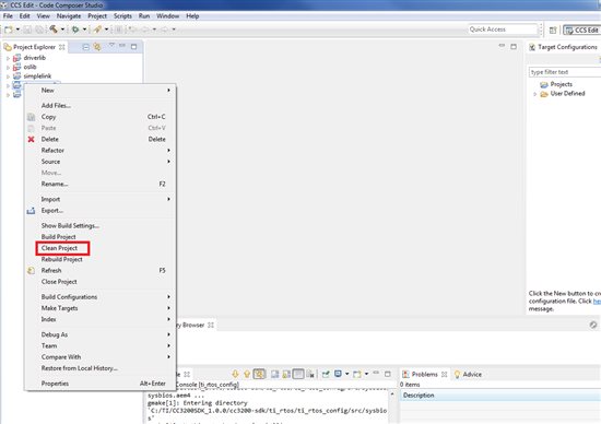

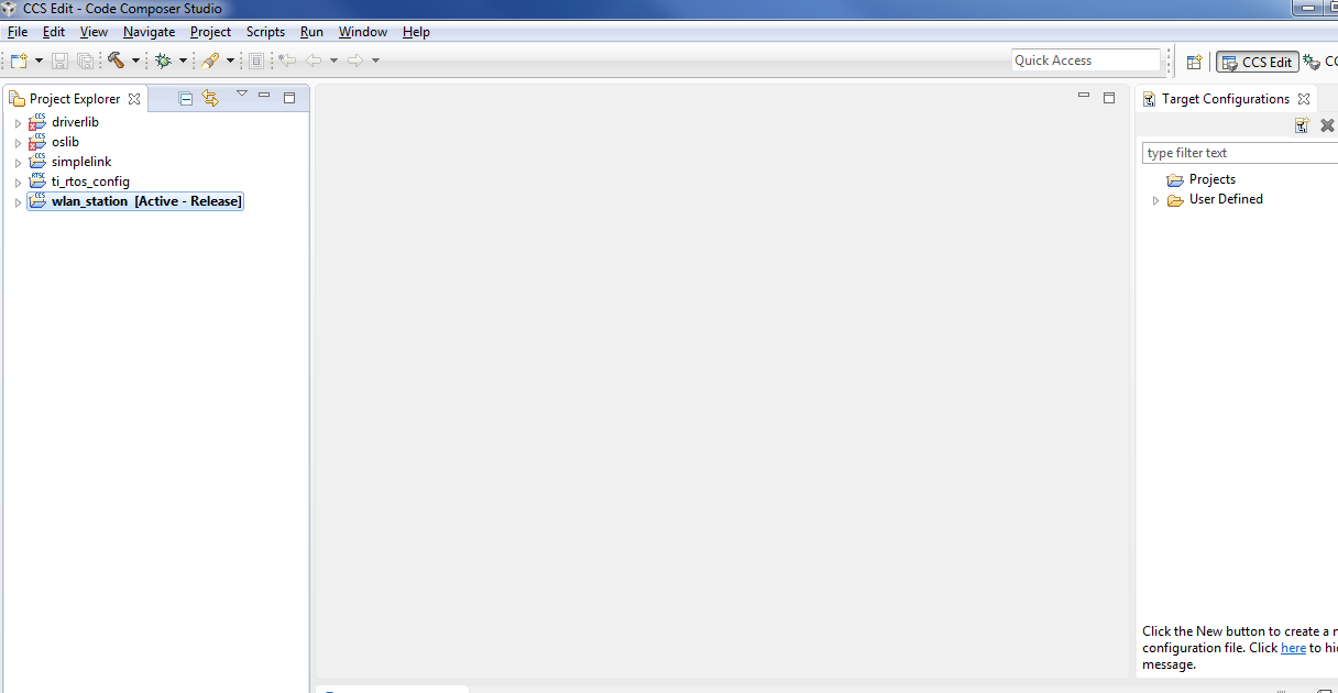

Hey Oguz,
I don't have a windows 8.x machine to test this out. I can say looking at the default installation path where you are missing linker.cmd "C:\TI\CC3200SDK_1.0.0\cc3200-sdk\ti_rtos\ti_rtos_config\ccs\Default"
If you right-click the project "ti_rtos_config" in CCS, (do NOT use the Project menu drop down or else it will only build the Active project) with the above listed folder open, and choose Clean Project, you should see only 5 files left.

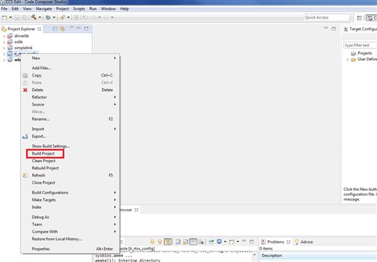

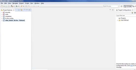

If you then right-click the project "ti_rtos_config" in CCS, and click Build Project, a folder called ..\configPkg\ should be created. If this folder isn't being created, I'd make sure CCS has permission to write to the disk in Windows 8.1

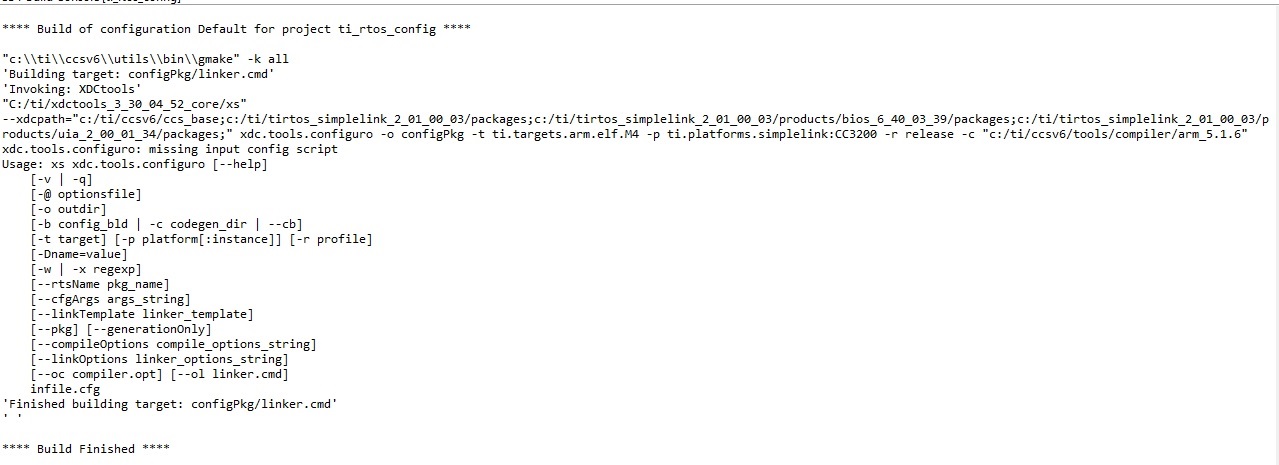

Oguzhan,
When I build the ti_rtos_config project, I see this in the build console:
"C:\\CCStudio_v6.0.1.00039_new\\ccsv6\\utils\\bin\\gmake" -k all
'Building target: configPkg/linker.cmd'
'Invoking: XDCtools'
"C:/CCStudio_v6.0.1.00039_new/xdctools_3_30_03_47_core/xs" --xdcpath="C:/CCStudio_v6.0.1.00039_new/ccsv6/ccs_base;C:/CCStudio_v6.0.1.00039_new/tirtos_simplelink_2_01_00_03/packages;C:/CCStudio_v6.0.1.00039_new/tirtos_simplelink_2_01_00_03/products/bios_6_40_03_39/packages;C:/CCStudio_v6.0.1.00039_new/tirtos_simplelink_2_01_00_03/products/uia_2_00_01_34/packages;" xdc.tools.configuro -o configPkg -t ti.targets.arm.elf.M4 -p ti.platforms.simplelink:CC3200 -r release -c "C:/CCStudio_v6.0.1.00039_new/ccsv6/tools/compiler/arm_5.1.6" C:/ti/CC3200SDK_1.0.0/cc3200-sdk/ti_rtos/ti_rtos_config/app.cfg
making package.mak (because of package.bld) ...
generating interfaces for package configPkg (because package/package.xdc.inc is older than package.xdc) ...
configuring app.xem4 from package/cfg/app_pem4.cfg ...
Comparing this with your build output, it looks like your command line is missing the input file app.cfg. If you expand the project in the Project Explorer view do you see the app.cfg file in the project?
