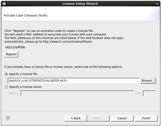

    I did also have a problem where on one Linux machine the CCS6 status bar and License Information Status view were both reporting "Unlicensed" even though I was able to perform actions which required a full license - see CCSv6 6.0.1.00039 Linux doesn't recognize flexlm hostid correctly. Not sure if the same problem could occur under Windows.

    If you go to Help -> Code Composer Studio Licensing Information -> Update -> Launch License Setup -> Activate and "Specify a License File" and point at your license file, does that fix the problem?
    Based upon your description, I was wondering if CCS has somehow reverted to trying to connect to a license server rather than use the node locked license file.
