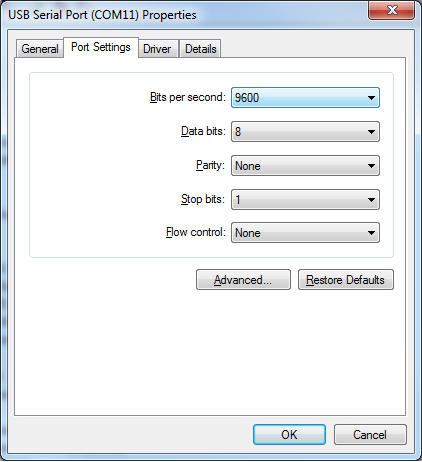

I recently started using GUI composer (on my custom circuit board with F28035) and it works great with USB JTAG connection. Now I am trying to make it work with UART connection.
Found this pdf and followed the instructions but still couldn't make it running
http://processors.wiki.ti.com/index.php/ProgramModelUart_GuiComposer
This is the error:
ComPort: Trouble Reading Memory Block at 0x9900 on Page 1 of Length 0x1: **Error**: Serial Communication failed at port: COM5, baud rate:57600!
I would expect the UART connection to suspend at main but it keeps running and i cannot suspend it.
Also looks like it requires Uart monitor running on the target but how do i do that?
Any help is appreciated!

  • In the error message "...Communication failed at port: COM5, baud rate:57600!" I see the baud rate is set to 57600.
    Would you be able to try 9600?
  • Changed to 9600 in .ccxml and device manager/COM5/properties, still same error
    Does it have to do with boot mode?
    I think that TRST is 1 and
    by default, TD0(GPIO37) =1 and GPIO34 = 1
  • You need to change the target program to 9600 as well.
  • how?
    appreciate your help
    Sandhya
  • These are my settings
    SciaRegs.SCIHBAUD    =0x0000;  // 9600 baud @LSPCLK = 15MHz (60 MHz SYSCLK).
    SciaRegs.SCILBAUD    =0x00C2;
    #define DSP28_DIVSEL   2 // Enable /2 for SYSCLKOUT
    #define DSP28_PLLCR   12    // Uncomment for 60 MHz devices [60 MHz = (10MHz * 12)/2]
    #define CPU_RATE   16.667L   // for a 60MHz CPU clock speed (SYSCLKOUT)

  • Hello Dobrin,
    Now I understand why it doesn't halt at main, thanks a lot for explaining.
    I am following the instructions in that document and I still get the com error as mentioned in my first post. Any ideas on that?
    -Sandhya
  • Hi Sandhya,
    UART port speed is definitely incorrect. it should be 9600 baud. Did you change the port speed setting in Device Manager on your PC? See attached picture for what my port setting is on com port where 28035 is attached to.
    Martin
