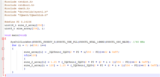

  • Here is a screenshot from CCS:

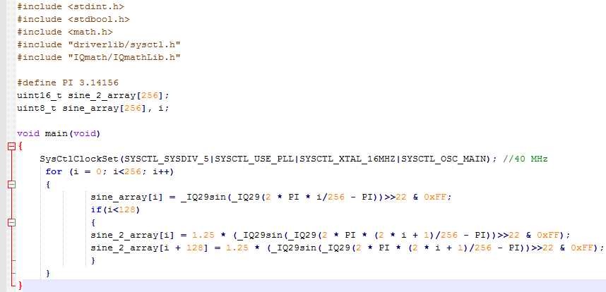

    Here is a screenshot of the same text as presented in Notepad++ with C encoding:
    Notepad++ encoding is not the same as CCS, but color is nice.

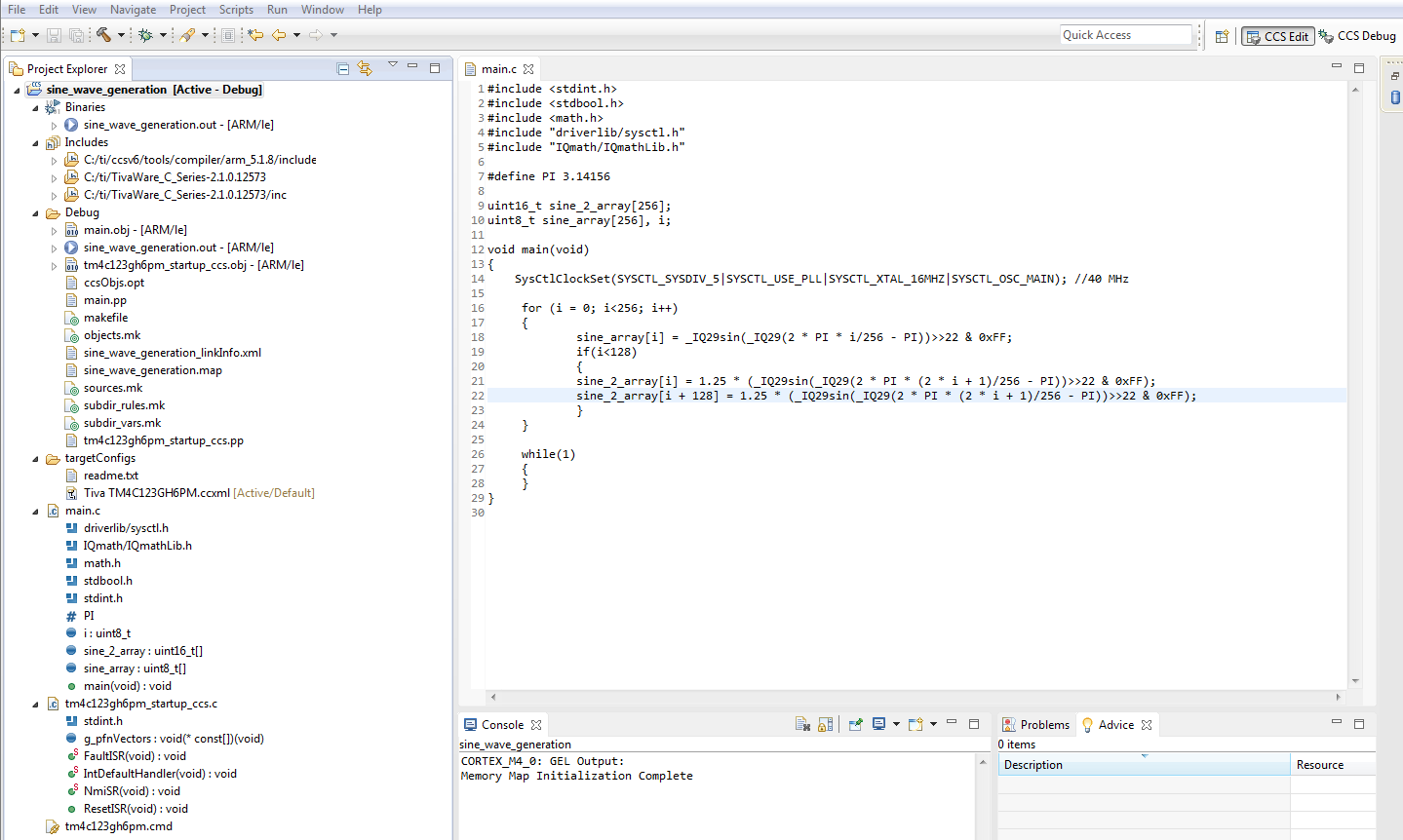

  • Something is definitely wrong. Can you actually provide a screenshot of your whole CCS environment? in that screenshot, I'd like to see your project in the project explorer, full name of the C file open and what perspective you are in.
  • Here is a screenshot of the edit perspective:
    I could only insert a file because the image is too big. I also have it stored in my public Drobox here. The file that is open is main.c.

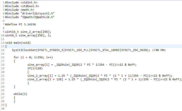

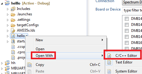

  • thanks. It looks like CCS is opening the file with the text editor and not the default C/C++ Editor. Can you explicitly open it with the C/C++ editor to confirm this?

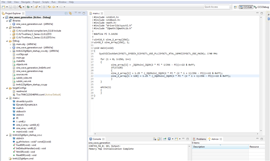

  • Way cool, Ki, that was it! Now I see the pretty syntax-derived colors, and I can set breakpoints as before. I'm cookin' with gas, now!
  • Cool!
    Looks like the default behavior got changed somehow. To change it back, use the same first context menu in my screenshot above but select the 'Other' item (it is cut off in my screenshot but it is the last item in the menu). A dialog will open where you can select the editor to associate with that file extension.
