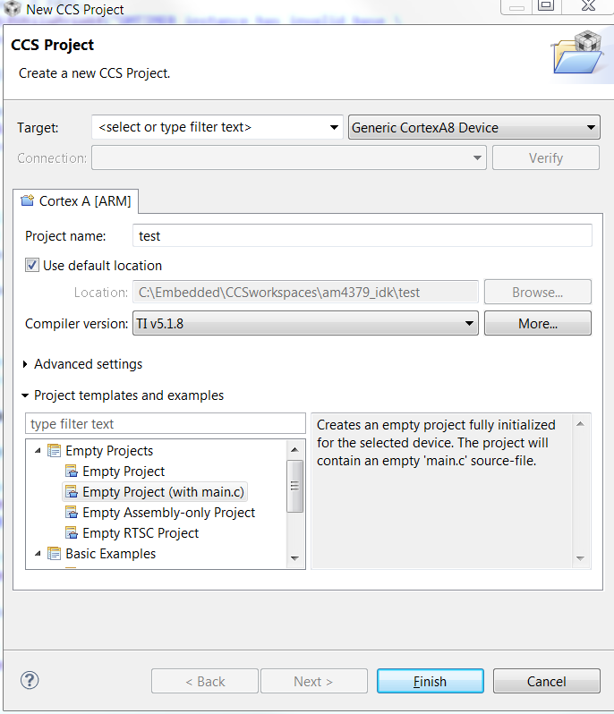

  • Gordon,
    I heard back from some people on the RTSC library question.  They were not familiar with that, did you mean a "RTSC Configuration Only Project".   You can create those by going to New Project -> Expand Advanced Settings and switch “Output Type” to “Other”, then expand Template section and choose “Empty RTSC-Configuration Project” template.
    John
  • Sorry, this was about building static library projects that use RTSC.  I was not aware that CCS could do this (I had only previously been able to do this using xdc itself as a packaging tool), and was confused because in an existing project you can't change between an executable and a static library target after project creation.  The drop-down box for target type is greyed out without any explanation which was not very illuminating.
    I then found that one creates static library projects under the 'Advanced' settings when creating a new RTSC project, but it's pretty subtle.  You have to notice a really teensy arrow next to the word 'Advanced' to see that there is anything else to see here.
    I might humbly suggest adding a 'RTSC static library' template project to make this clearer.
