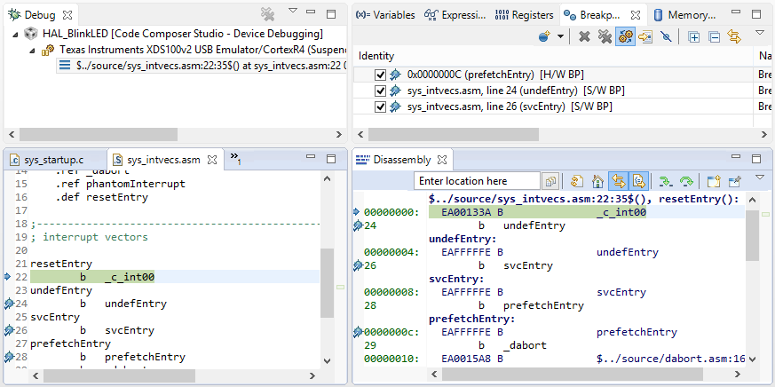

    EDIT: Here are some screenshots of the setup and results. The first is showing step 6 after setting the hardware breakpoints. I added one at line 24 in the source view and one at line 26 in the disassembly view (on a source code line between the disassembled opcodes). The third breakpoint was placed in the disassembly view on the opcode at address 0000000c:
    Next I terminated and restarted the debug session. Here's a screenshot during the launch process (at step 8), while the flash is being erased:
    Notice how the breakpoints at lines 24 and 26 are now disabled software breakpoints, but the breakpoint at 0000000c is an enabled hardware breakpoint. I'm not sure if this is relevant, but it does show the point at which the source breakpoints change their displayed type from H/W to S/W.

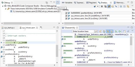

    The next image shows the situation once flash has been cleared and the firmware uploaded at step 9:
