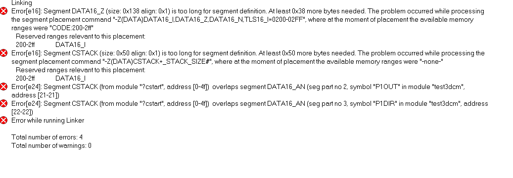

I tried running the same code with code composer studio and getting following errors:
error #10099-D: program will not fit into available memory. run placement with alignment fails for section "BSS_GROUP" size 0x138 . Available memory ranges:
RAM size: 0x100 unused: 0xb0 max hole: 0xb0
error #10010: errors encountered during linking; "DCM_CCS.out" not built
Please correct me if I am wrong: as per my knowledge with MSP430F123 I have only 256 bytes of ram memory where all my global variables, local variables and stack implementation get stored. I am using port1 and timer interrupt. I am not sure how to fit this code any help will be appreciated.

You are correct that MSP430F123 has only 256 bytes of RAM. You are attempting to place an array of size (15*20+8) = 308, so it cannot possibly fit in RAM. Can any part of the array go in FLASH? Must the array be that large?

Your problem starts with this C source line ...
unsigned char Bdata1[340];
That array goes in the .bss section. The linker command file allocates the .bss section into RAM memory. But your device only has 256 bytes of RAM.
You have to change your code to use less RAM. If you aren't sure of the best way to do that, then I suggest you start a new thread in the MSP430 forum.
