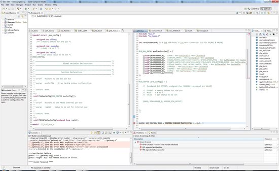

Hey there,
i'm having some trouble with coding the pinmux.
using the macro HWREG() i'm getting an syntax error. (it is declared)
for further information see screenshot.
kind regards!
  • Hendrik,

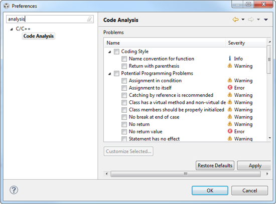

    Is it giving you an actually build error or just the "?" marker in the editor?  If it is just the ? market that is the static source code analysis checker.  It does not recognize the macro HWREG and is reporting it as a potential issue.
    It is possible to turn this off.  If you go to Windows -> Preferences.  Type analysis in the filter box.  You can then disable the various analysis features.
    The tooltip for the marker should indicate which rule is triggering it.

  • Hey John,
    thanks for your reply!
    after building i'm getting further erros. see the screenshot.
    i included the hw_types.h.
    for your information: im trying to enable the UART4 to send messages.
    du you have any suggestions?

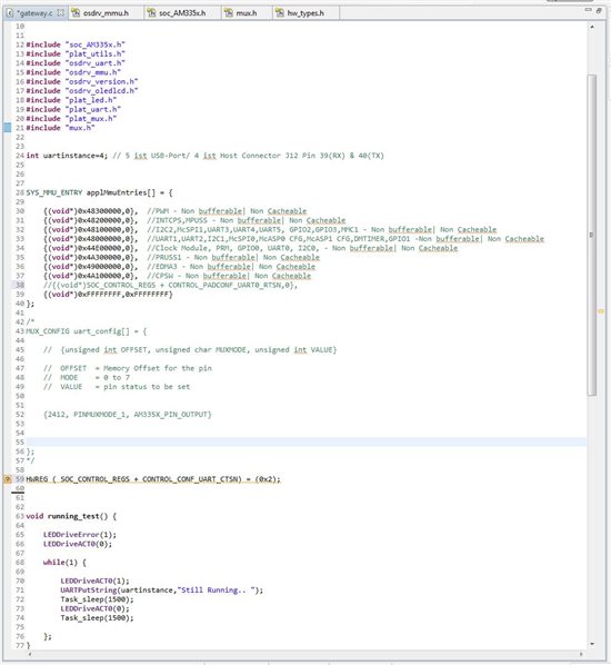

  • I am not sure on the usage of the HWREG macro.
    #define HWREG(x) \
    (*((volatile unsigned int *)(x)))
    I don't think what you have evaluates to a valid statement
    HWREG( SOC_CONTROL_REGS + CONTROL_PADCONF_UART0_RTSN ) = 0x2
    That would end up with
    (*((volatile unsigned int *)(SOC_CONTROL_REGS + CONTROL_PADCONF_UART0_RTSN))) = 0x2
    The Sitara team may better know how that StarterWar macro is meant to be used.
    john

  • Make sure you are using the correct identifier within HWREG. For AM335x, in the file hw_control_AM335x.h, I see defines for CONTROL_CONF_UART_CTSN(n) and CONTROL_CONF_UART_RTSN(n).
    But you are using CONTROL_PADCONF_UART0_RTSN which I don't see defined in any of the header files in AM335x Starterware. Double check that and make sure you are using the correct identifier. If you still need help after checking on that, I would suggest posting to the Sitara forum as John suggested.

  • Do you get the same error if you put the HWREG() statement inside a function rather than at file scope?
  • i'm sorry i did a mistake like that.
    of course i should put it into a function.
    HWREG(SOC_CONTROL_REGS + CONTROL_CONF_UART_CTSN(0)) = 0x2;
