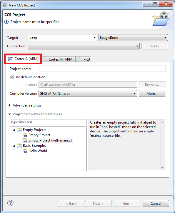

  • What device are you selecting in the new project wizard? If it is a device that has a programmable ARM, you should see a tab for it:
    If it is missing, can you show me a screenshot?
    ki
  • Hi Ki,
    This is how it looks on my side. I have only a PRU tab. I can select AM33x and AM473x targets and it looks the same for all of them..

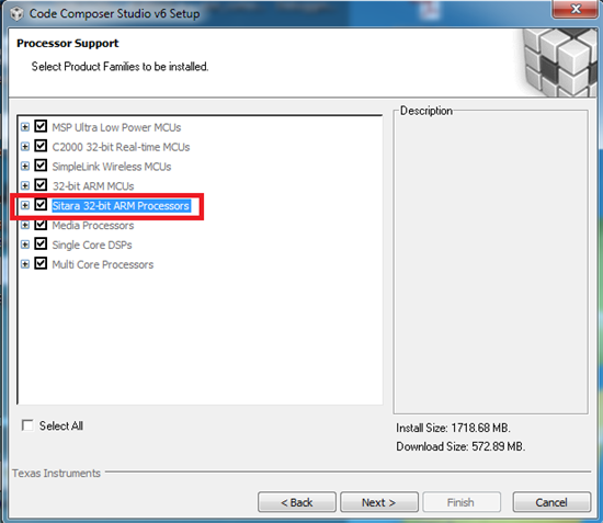

  • It does look like you are missing the Sitara components... except you said you installed them.
    If you re-ran the installer and added the option I highlighted below, you should have it...
  • Thanks Ki, I'll do this.
    Although I believe that selecting Help->Install New Software...  and then choose Device Support should have done the job. After all, I'm able to select Sitara devices when creating a new project which indicates that adding new devices partially did work, but obviously not completely.
    Roland
    ah. I was wondering if that is what you originally tried. No, that is not enough. That will add additional device support for device families that are already installed. It doesn't install all the dependent components to use them. You need to rerun the installer for that.
