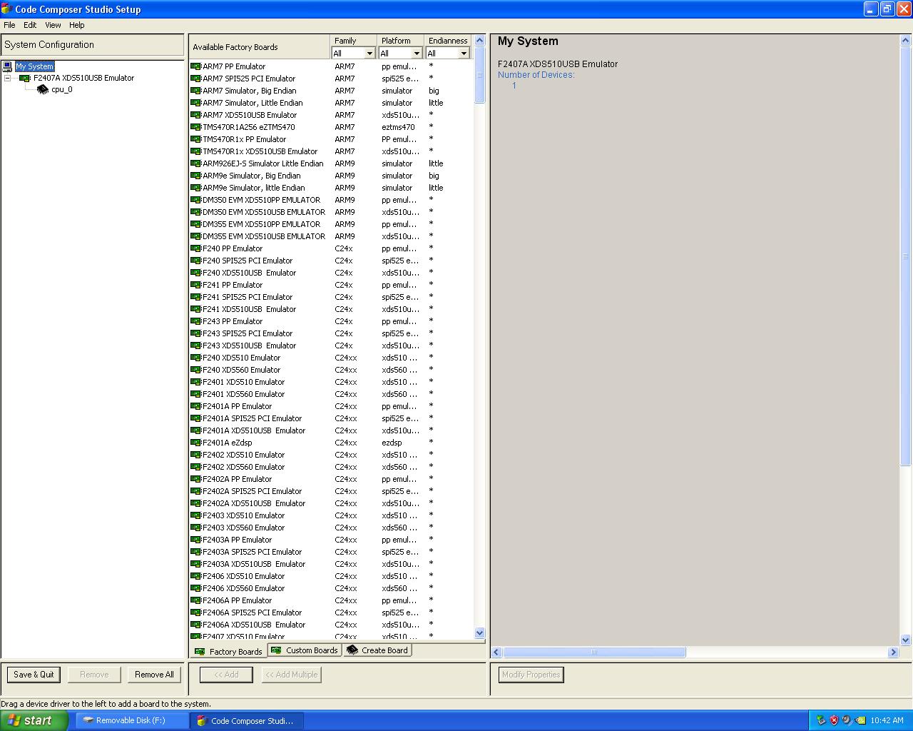

    Can you post a screenshot of your configuration in CCSetup?

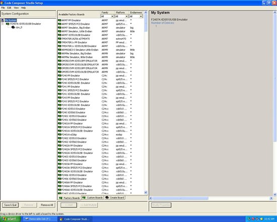

    the ccs setup
    I try with a XP and still have the same problem to connect to the target.
    BR,
    Alan
  • Looks like you have a good JTAG connection with the device and the target configuration is correct.
