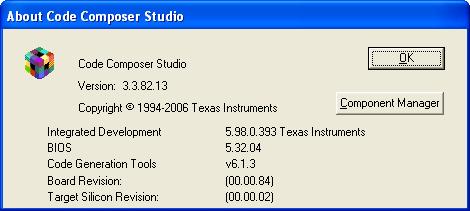

  • You're right, I do recall known issues in the past where RTA views stopped updating. They might have been fixed in later service release updates to CCS 3.3. What exact version of 3.3 are you using?

  • Hi Edwin,
    The latest world I have is that there are known issues with RTA updating, even with the latest version of 3.3. These issues appear to have been resolved in CCSv4. However, you would need to update to BIOS 5.4 to get it. From what I understand, the difference between 5.32 and 5.4x are very minimal and they are binary compatible. It is up to you if you wish to upgrade to v4 and BIOS 5.4. CCSv4 is a very different environment in terms of look and feel so there will be a learning curve transitioning from v3 to v4.
