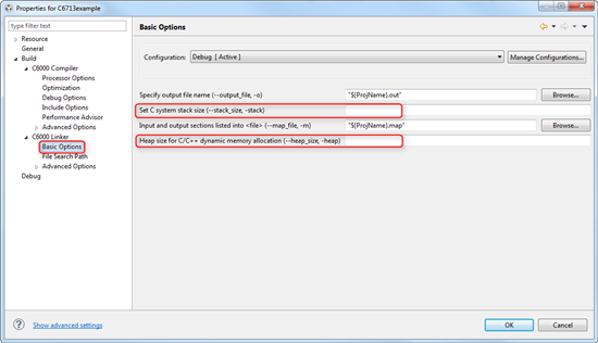

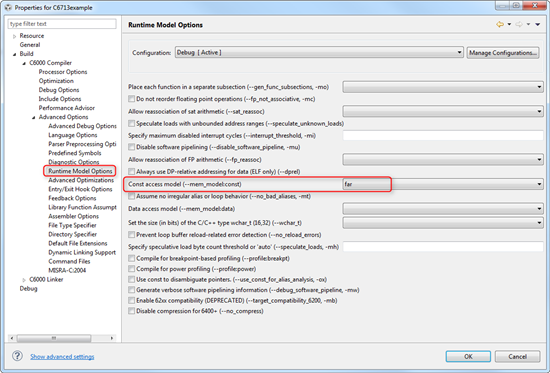

My teacher's PPT of Realtime Digital Signal Processing using C6713 dsk gave us the template of creating the new project.   Note that the CCS is 5.4.0 version.  He denotes that we should reset some parameters in the "Property of Project"
1-Adding CSL and BSL.
2-Amend both the stack and heap size as 0x400
3-Const access model and data access model should be both set as "far"
4-Other settings which I understood.
I could not understand the first three settings.  Especially the second and third one.

  • Here is where you set the stack and heap size.  I would suggest looking up what these things mean as they are pretty essential to know.

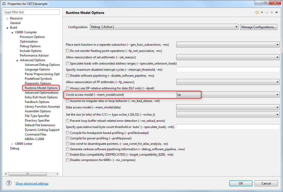

    Here is where you set the access model to far.  If you look in the C6000 Compiler Users guide that is in the help you can learn more about what this means.
