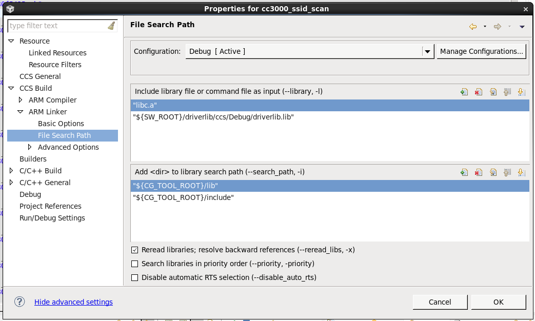

    Those unresolved symbols are in the TivaWare driverlib.
    From the linker command line, I can't see the TivaWare driverlib.lib in the list of libraries, which explains why the linker reports unresolved symbols.
    Under the CCS Project Properties driverlib.lib should be in the linker --library list:

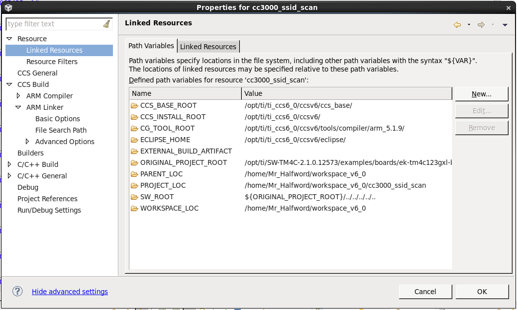

    In this example the driverlib.lib file is given relative to the SW_ROOT path variable, which has been set in the Linked Resources to point to the TivaWare installation:

  • Roberto,
    It looks like you have resolved the linking issue you had, but I will try to comment on some of your other questions/comments.
    You should be able to make a copy of a project (by using copy and paste in Project Explorer view) and the copied projects should retain the settings such as include paths, libraries/search paths etc. If you wish to start a project from scratch, you can do that too, and then you would need to make sure to manually add all the necessary options to make it work for your device and with TivaWare. Using a TivaWare example as a reference would be the way to start.
    Roberto Romano said:
    some project work just with libc.a other require explicit driverlib and TIVAWARE link
    This depends on what the code does/requires and is not something preset in the IDE. Programs that don't do anything with peripherals would not require driverlib or other libs from TivaWare while those that do use peripherals would need them.
