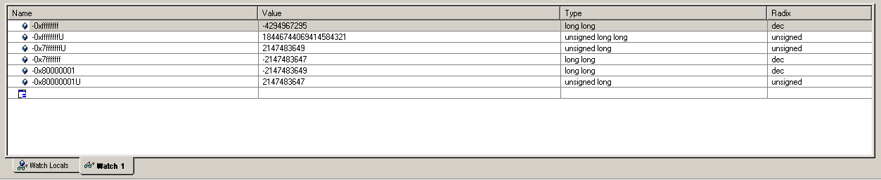

  • Hi Archaeologist,
    I have debugged the code and entering the value 0x80000000 in the debug watch window the data type is presented as long long,
    and the decimal value is displayed as 2147483648.
    It is irritating to your statement.
    Kind regards,
    JD

  • Thanks. Can you please still have a statement on what is happening in the debugger.
    There, 0x80000000 is displayed as long long value and the decimal value is 2147483648.
    Any idea?
    JD
  • I believe that is a bug in the debugger, but I am not an expert on the debugger. What version of the debugger are you using?  I've submitted SDSCM00035598 for further analysis and tracking.

    Moreover, debugging in CodeComposerStudio is irritating as
    the wrong data type and value is diplayed for 0x80000000 (long long 2147483648).
    Obviously, the debugger has a bug.
    I myselft use CodeComposerStudio 3.3
    JD

  • I'm sorry I have been unable to respond earlier, as I've been ill and unable to spend time thinking about this issue.  Perhaps I can blame the illness for the several mistakes I've made.
    The latest mistake is that I posted an incorrect correction.  The truth is that 0x80000000 has unsigned long type.  I'll go back and edit my post where I made the incorrect correction.
    The value of a constant is determined before its type.  That is, the value of 0x80000000 is 2147483648.  It is this value which is consulted when looking through the table, and this value will not fit into a signed long.  Thus, the type of 0x80000000 is determined as unsigned long, the first type in which the value can be correctly represented.  Similarly, 0xFFFFFFFF has value 4294967295, and is also an unsigned long.
    I've attached a test case to demonstrate that this is the way the compiler is doing it.
    Julian Dieterle said:
    if (lA == 0x800000000) /* data type of lA is long int*/
    no cast is performed, as both data types are long int.
    0x80000000 is unsigned long, so lA is converted to unsigned long before the comparison.
    Regardless, at no time should "long long" or "unsigned long long" enter into the picture.
    Well, it seems to me that this is a bug in the debugger (SDSCM00035598).  My rationale would be that the debugger should follow the rules of the C standard as applied the target-specific type sizes in the implementation, and assign the same type that the C compiler would.  However, it's not absolutely clear to me that that's the rule the debugger should be following, and I'll let someone from that team address that issue.

  • Hi Archaeologist,
    it is good to hear that you are back again.
    Thanks for your explanation. I have added an attachment which shows what CC Studio makes wrong.
    Thanks again!
