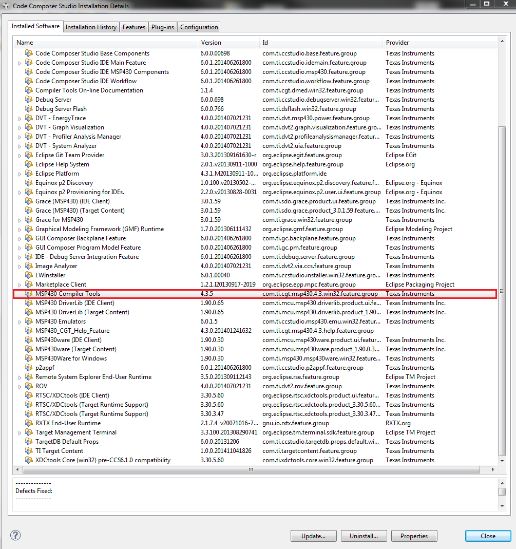

  • Please check the image below, it shows MSP430 compiler tools 4.3.5 and not 4.4.1.
    We are using customized makefiles for our projects so it's good to have some clarity over the version of the tools we are using, especially the compilation tools. What is then the most recent version of MSP430 compiler?

  • If you have 4.3.5 tools installed and then install 4.4.1, you should end up with both installed.  They are distinct features as far as the CCS Installation Details window is concerned.  You should have both of:
    • com.ti.cgt.msp430.4.3.win32.feature.group
    • com.ti.cgt.msp430.4.4.win32.feature.group
    Try sorting by the Id column
  • There's no action when I click on the Id box, list remains the same, is there some other way to sort it? Anyway, I looked at all the components one by one and I only have com.ti.cgt.msp430.4.3.win32.feature.group

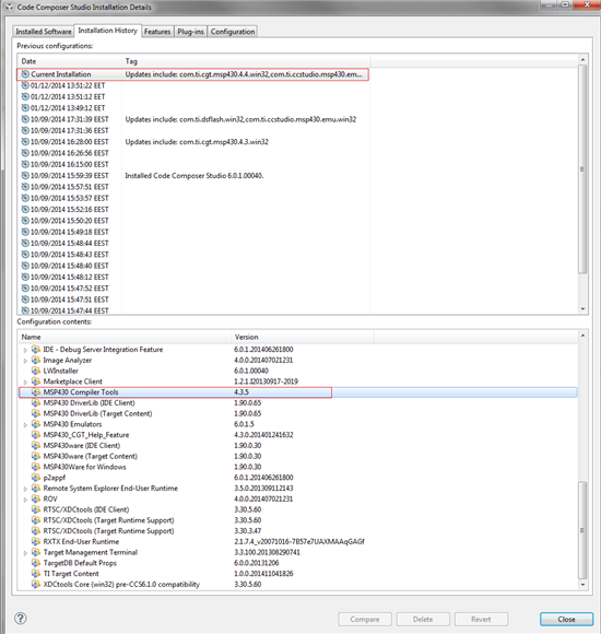

  • Check the image below from the installation history. The update for the correct version is mentioned but the configuration content shows 4.3.5.
