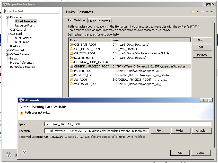

I got one project from my friend and trying to run it in my laptop but getting this error plz help.
"*** No rule to make target `E:/Program Files/CCSv6/TivaWare_C_Series-1.1/utils/uartstdio.c', needed by `utils/uartstdio.obj'."
I tried different options gave all the include paths and links properly but still getting the same error.
I am using Tiva C-Series TM4C123GH6PM launchpad and CCSv6. In the device configuration I am giving it target Tiva C Series and at connection I am specifying Stellaris In-Circuit Debug Interface because tiva is not in the options

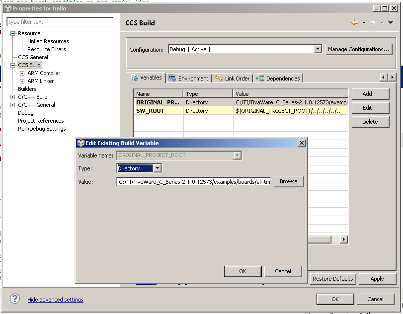

    When an example project which uses TivaWare is created it stores the location of the TivaWare installation in two places, when when the project is imported on a different PC which has TivaWare installed in a different directory, must both be changed to allow the project to compile.
    The first is the ORIGINAL_PROJECT_ROOT Path Variable (which gives the location of the linked resources such as the utils/uartstudio.c file):
    The other is the ORIGINAL_PROJECT_ROOT Build Variable (which sets the Compiler include and linker paths):
    Are the ORIGINAL_PROJECT_ROOT Path Variable and Build Variable both set to point at the TivaWare installation on the PC on which the project fails to build?
