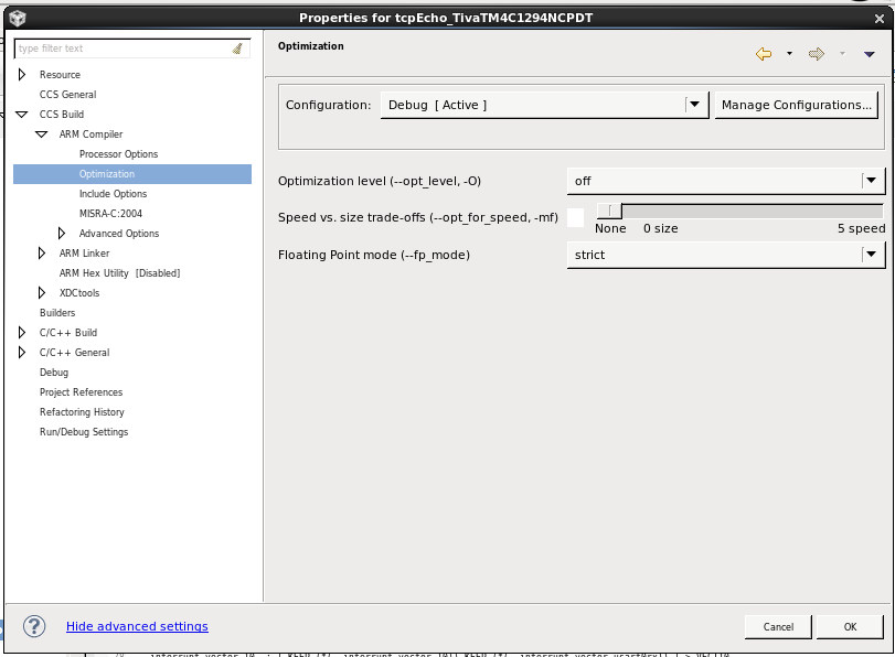

    I downloaded and installed the latest CCS-6.0.1 and it behaves exactly the same as CCS-5.4. In debugging single step, it first jumps to the 1st 2 lines of source code at the beginning, then it jumps back & forth like crazy, not following the source code at all!!!

  • Duy-Ky Nguyen88210 said:
    I'm able to compile TM4C123 examples, load and run. But, in debugging the code, it jumps back and forth like crazy, not following the code flow.
    Some of the TM4C123 examples have the Compiler Optimization Level set to "Global Optimizations" which can cause the compiler to generate assembler out-of-order .w.r.t. the C statements.
    To prevent such confusion while single stepping in the debugger, try setting the Optimization Level to "off" in the CCS Project Properties:
  • Yes, you're absolutely correct. I turned off optimization and it behaves as expected, even with CCS-5.4
    Thanks so so much, Gautam
