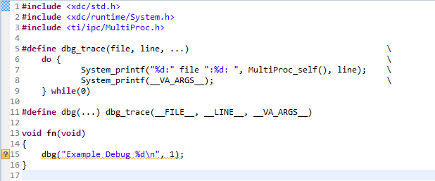

CCS 5.4.0 incorrectly flags variadic macro expansion as a syntax error
The following code snippet shows a syntax error on line 15:
But the code compiles without any errors. If I preprocess this file (with --gcc extensions enabled, of course), I see:
which is what I expect.
A similar construct gets used a lot in our code, and the numerous "syntax errors" are distracting. How can I make the editor stop doing this?
Paul

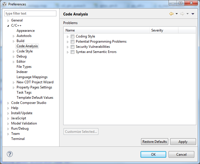

  • Paul,
    You could try disabling the Code Analysis features.
    I believe in v6 we have a number of the rules disabled.  You can selectively choose which ones to turn on and off.
    John
  • John,
    Thanks. I disabled them all, closed CCS, and restarted.
    I still see the code highlighted as shown in my orginal post. When I hover my cursor over the Question Mark icon, the tooltip says "Syntax Error."
    Perhaps this is a problem with the C++ lexer/parser?
