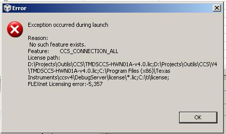

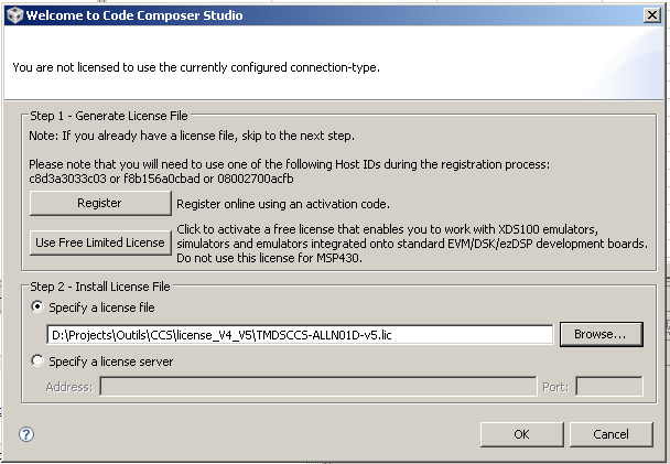

Customer is having issue with license. It seems like the path entered isnt taken into account. Customer has upgraded a free install (tied to XDS100 / evm).

  • Looking at the screen capture it looks like the free license is a CCSv4 license and the one they are attempting to switch to is a CCSv5 license. Thus I believe they are running CCSv4. The CCSv5 license should work fine with CCSv4. Try having them remove the free CCSv4 license and place the CCSv5 license under /debugserver/license in their installation directory.
