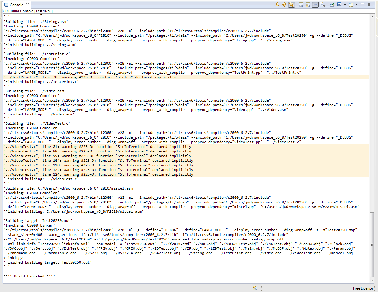

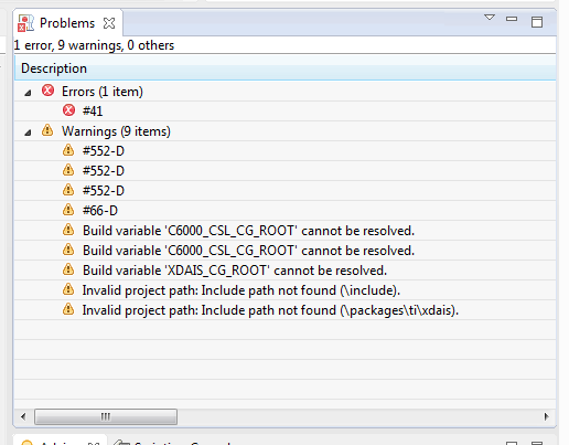

Im running CCS v6.0.1.00040 and im having trouble with compilation warnings and errors. Instead of getting an explanation I just get for example "#179-D" and "#552-D". Is there something obvious im missing?
Can you show the part in the build console where the warnings #552 and #66 appear?
One known issue that I am aware of is if the warning message spans more than one line, and the build option --diag_wrap is NOT set to off, then the warning text will not appear in the Problems view. This is because, with that diag_wrap setting. the Problems view displays whatever appears in the first line of the warning message but not the rest. However, I see that you have --diag_wrap=off so I am not sure why it is not showing the text.
If this is reproducible with a small test project that you can share with us, we can look into it some more.
