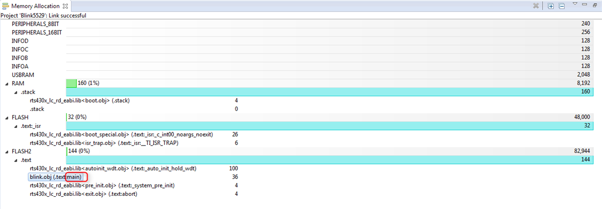

    I am not sure which version of CCS you are using but you can go to the View menu and select "Memory Allocation"  this will show you more details on how memory is being used.
    Here is an example.  In red you can see the function main.
    Note that the same information is in the map file.  If you search for your function you should see it.
