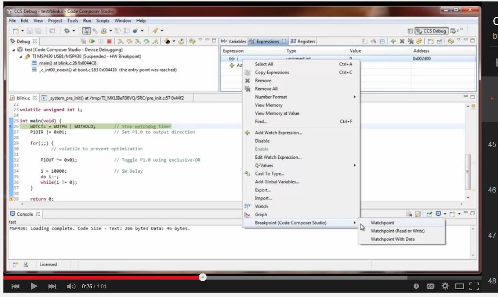

I followed the TI trainning website of using the CCS.  It is the youtube video lecture.  This lecture helped me how to pinpoint a variable and set the breakpoint of this variable.  Then I hit the "run" from the debug console and this variable can change one-by-one if I hit the run again and again.
However, I cannot realize this one-by-one debugging because I cannot find the "watchpoint" choice in my CCSv5.
I can let you see the snapshot of the video lecture I saw:
You see, the tutor in youtube video let me hit Watchpoint if I right-click the variable from the "Breakpoint" view.
But I cannot find the Watchpoint there!
Could you please tell me how to realize the step-by-step tracing of the variable at CCSv5?

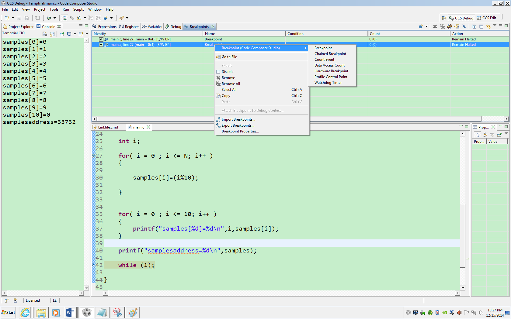

this is my snapshot of my CCS:
    You can add the same window by going to CCS -> Window -> Show View -> Breakpoints/Watchpoints
    Which device are you working with? The emulation features vary by device so it may be that the device you are working with supports a smaller number of triggers hence does not support watchpoints. Please refer to this training module and this app note for more information.
