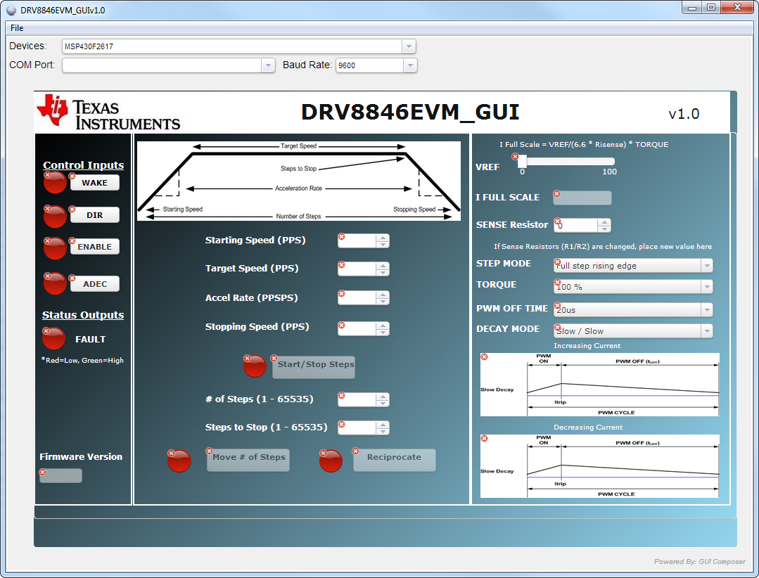

I created it and dropped the folder DRV8846EVM_GUIv1.0 into it, all the files and folders indicated are there in the correct order
launcher.exe does nothing but run the hourglass 3 seconds.
When I double click launcher, no new processes appear to start under Task manager
The board is not connected to the USB port (dont have board yet, trying to test the SW first)
Must it be connected before the Eval SW runs?
  • The users guide directs you to install the GUI Composer runtime and not Code Composer Studio (CCS).  Basically the runtime contains the portions of CCS needed to run GUI applications without the CCS environment.
    If you go to
    you can download the GUI Composer runtime.  It will install by default in c:\ti\guicomposer  Then you can copy the tool into the c:\ti\guicomposer\webapps folder.
    Doing this I was able to get the GUI to come up without having the board connected.

  • David,
    I am sorry that you are upset. It was not my intention. I was merely pointing out that the Users Guide for the EVM GUI referred to the GUI Composer Runtime download site vs the Code Composer one. With the similarities in branding it is easy to mix them up especially if someone is new to our software offering. That is why I tried to explain the difference.
    GUI Composer is available as part of Code Composer. How it is included depends on the version being downloaded. For Code Composer Studio v5 it is included directly in the installation. For Code Composer Studio v6 it is available via the App Center. Code Composer Studio v6 tries to reduce the overall download size and as a result some of the features have moved to the App Center so that they are downloaded when needed vs having everyone need to download them. I agree that the GUI Composer webpage should be updated to reflect this. I will ensure that it gets done.
    The App Center can be accessed either from the Getting Started view that opened when you first started CCS or you can go to the View menu and select "CCS App Center". GUI Composer should show up in the first row.
