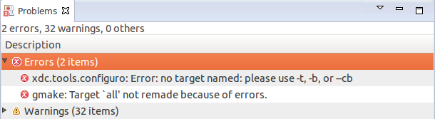

If I make a new project, and just copy the files and folders from thingsquare-mist-1.1.0 into the project, and build it right away, I get the following two errors:
I'm a little confused about if the make files from the thingsquare mist code is getting used, and if it does, how do I set the target board?
Thanks, Jesper

  • I have figured out what went wrong. In case other newbies like me get into the same trouble, here is what I did:
    First of all, I had to disable "Generate Makefiles automatically", and then set the Build location to the specific example I tried to build, in this instance "blink".
    Then in "CCS Build -> Behaviour" under "Build" I added: "blink.bin TARGET=ek-tm4c1294xl-1120em-tiva", and under "Clean" I added: "TARGET=ek-tm4c1294xl-1120em-tiva clean". This will allow the project to be compiled like if the example was build from the command line.
    In order to make hardware debugging word, one have to add "CFLAGS += -g" in the application specific Makefile. The last thing to do is to correct the "Debug Configuration" under "Program" to point at the output generated file that in my case was "blink.ek-tm4c1294xl-1120em-tiva".
    I hope it might help others.
