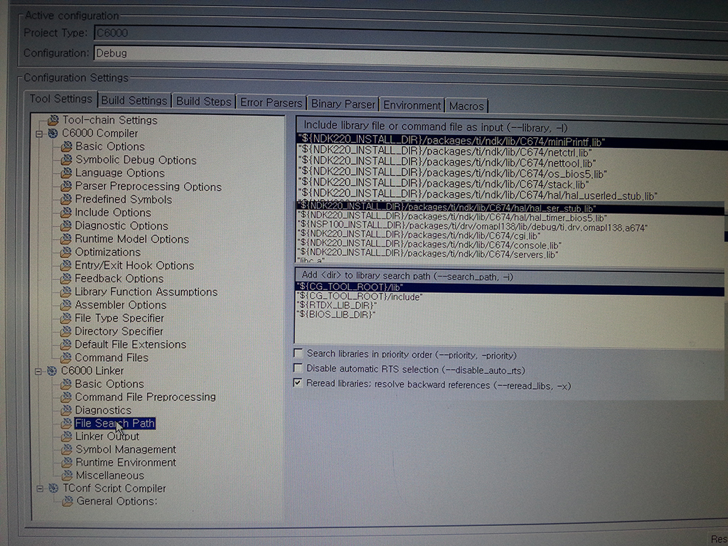

  • I included libraries as above picture.
    You said RTS library, is there anything to include ?
    What is the RTS library supports rand() function ?
  • The RTS library is automatically linked for C programs. Is your program a C or assembly program?
    The RTS library will be named something like rts6740.lib
  • I wrote my development environment above, Title.
    I am using CCS v4.2.4, Dsp/Bios 5.41.10.36.
    I included <stdlib.h> and ${RTDX_LIB_DIR}.
    Do I have to be included more ?
