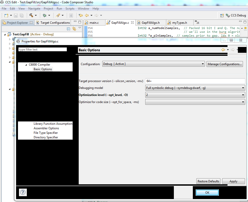

This recently started happening when I started using the simulator. I'm also using the profiler which may or may not be related. The screenshot below shows whats happening. It doesn't take CCS long before it starts misbehaving. I have to restart in order to get it painting properly again.  ;(
The CCS heap is at 101M of 1016M.
Is there a way to fix this? I typically use the XDS560v2 with an EVM, but I'm doing function optimizations so would like to use the profiler.

  • Hi Eddie,
    Did you try repairing CCS/installing again ?

  • Yiks, re-installing is a scary thought when it comes to CCS. I may give it a try.
    I've been using the EVM all day today and no screen painting problems (and I've never seen this problem with the EVM prior to using the simulator). So its definitely a bug in either the profiler or the simulator.
