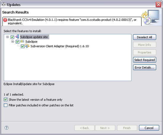

I installed the Platinum version of the CCS 4.1.1 with now issues.  Then when I ran it, the program indicates there is an update to review.  When I review it, the message indicates a subversion Client Adapter update is required.

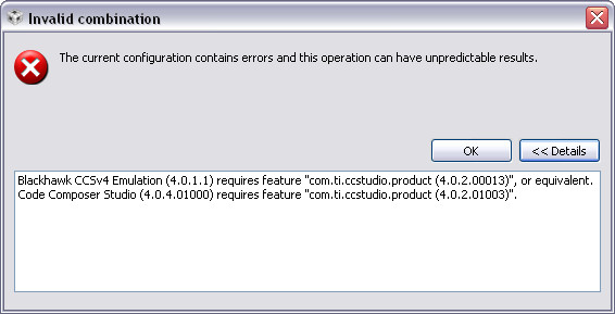

But, it does not give me a way to select next, it stays grayed out.  I did use Eclipse on a previous project and probably have that version still installed.  But, why would it not allow this update?  The only other information it provides is the error details which is complaining about CCS 4.0.4.0100 and Blackhawk CCS v4 Emulation 4.0.1.1.

  • Update manager looks like it might be confused by some content that was left after the uninstall of the previous version. Specifically, update manager looks like it is finding the feature.xml files for the com.ti.ccstudio.product.update404_4.0.4.01000 and com.blackhawkdsp.ccstudio.emulation_4.0.1.1 updates.
    There are two ways to address this. The most straight forward way would be to uninstall the CCS version you currently have, browse to the install folder (i.e. C:\Program Files\Texas Instruments\CCSv4) and delete any remaining files. Then, run the installer again to reinstall CCS.  An alternative would be to leave your current install as is, and install CCS again into a different folder.
    The second way to address this would be to try to remove the left-over content that is causing this problem. It will take a few iterations to find an remove the feature configuration errors. I recommend going with the first suggestion if at all possible.

  • That worked.  Thanks you very much!
