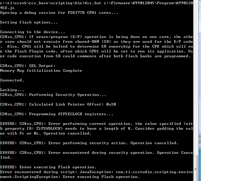

Hello:
    I get a error when I used CCSV6 scripting to perform the operation of "Z1OTPSECLOCKProgram".
    I had set the id Z1PSWDLOCK to "FFFFFFFF" in the scripting. But when I perform the operation of Z1OTPSECLOCKProgram, I get a error of " the value specify < with property ID: Z1PSWDLOCK> need to have a length of 8" .
The attachments is the scripting and the error report. The device is F28377D. The emulator is spectrum digital xds200.

Here is the Error report:
    You need to set the flash options AFTER the target connect call. Hence move the following lines:
    session.flash.options.setString("Z1PSWDLOCK","FFFFFFFF");
    session.flash.options.setString("Z1CRCLOCK","FFFFFFFF");
    to AFTER the target connect call:
    session.target.connect();
    Example:
     env.traceWrite("\nConnecting to the device...");
     env.traceWrite("Connected. \n");
     //session.flash.listSupportedOperations();
     env.traceWrite("Locking...");
     session.flash.performOperation("Z1OTPSECLOCKProgram");
     env.traceWrite("Completed.\n");
