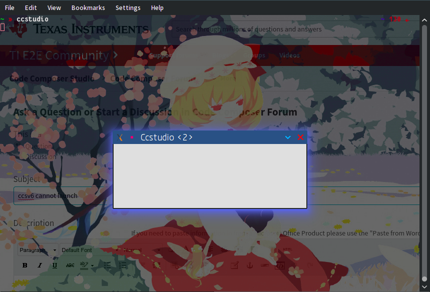

Long time since my last time launching ccstudio 6, in these months I updated my openSUSE from 13.1 to 13.2.
However it won't launch now, I have tried to remove all installed file and cleaned configurations then re-install (dependency is still OK), but it still not wok .... I don't know what is the error.
The last thing ccs has done before error(strace):

    Is this a 64-bit version of openSUSE? If that is the case, I imagine the update procedure perhaps uninstalled the 32-bit libraries necessary for CCS to run.
    Also, do you have a list of all the dependencies you needed when originally installed it? Unfortunately I am not well versed in this distro (and we don't officially support it), but I am trying to install it in a VM and see if I can get past the initial steps.

  • Yes it is 64-bit distro
    I checked twice and I am sure library dependency are all sufficient, anyway to enable debug information? I am not familiar with options of Ecplise.
    I had a break today and was able to successfully install and run CCSv6 on my VMware running OpenSUSE 13.2 64-bits on Gnome. The procedure I followed is shown in the link below and I was able to open it successfully - although I did not try to connect to anything at this point and may not be able to do so in the short term due to other priorities.
    http://processors.wiki.ti.com/index.php/Linux_Host_Support_CCSv6#OpenSUSE_13.2_64-bit
    Therefore it is possible there is some missing component in your system.
    As I said before, we don't provide official support for this distro and probably will not be able to be of further help. In this case I can only recommend installing one of the supported distros (Ubuntu or RedHat).
    Rafael
  • Thank you, I fixed all the dependencies and it can launch now.
    I'm using KDE, I think it can be marked as tested.
