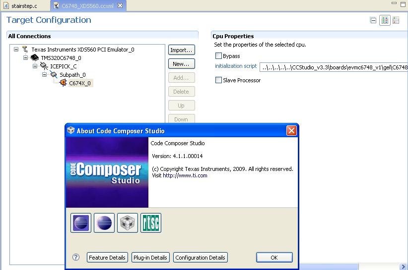

    From your problem description I really think you are having trouble accessing external memory. This is commonly caused by a misconfiguration of the DDR timing registers, which prevents any external memory accesses. Just as a cleanup check, did you add the the <c6748.gel> to the target configuration file (.ccxml)?
    I am asking this because I managed to access the external mDDR on my EVM (loaded with the C6748 SOM like yours). I am using CCS4.1.1.00014 and a XDS560 PCI connected to the TMS320C6748 device. I added the <c6748.gel> file to the configuration (don't pay attention to the path of the GEL file; it can be installed anywhere in your system).
    The external memory starts at 0xC0000000 and goes to 0xC7FFFFFF (128MB physically installed on the SOM).
    As you noticed, the GEL file <c6748.gel> covers the complete 512MB of external memory space, but any attempts to write to an address higher than 0xC7FFFFFF wraps back to 0xC0000000. This is a bug in the GEL file and can be easily fixed by simply adjusting the DDR2 Data memory size. The linker command file is correct.
