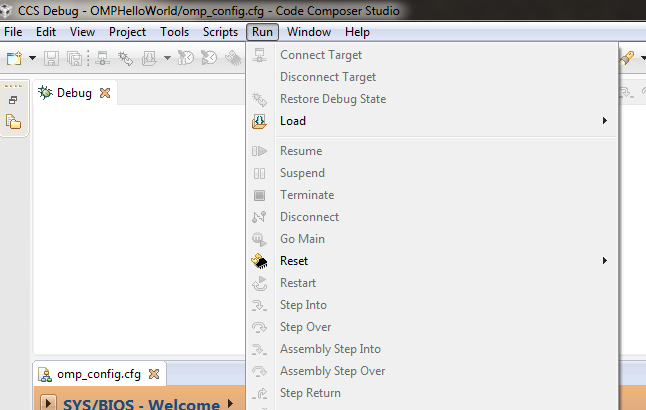

I am using CCSv6 with an XDS560PROTRACE with a EVM6678L.  In the Debug perspective under Run menu, the Connect option is grayed out, as are all the Load options.  Several examples I'm trying to work thru say something like load -> load program ...  but that doesn't seem to be an option.  If I create a debug configuration and launch that, it seems to work.  Why doesn't the Connect menu option show up?

    . I have opened the Debug Perspective, and the Debug View is definitely open, the menu options show up, but are grey.
    Many items should be grey if you have not connected to the target since actions like load program, run, etc require a connect target. However the first menu item under 'Run' is 'Connect Target'. This should be available if a debug session was successfully started. Was a debug session successfully started? If the Debug view is completely blank, the answer is "No'. There should be some content there. If you can post a screenshot of your debug view and the contents of the Run menu, that would be helpful.

  • The Debug View is completely blank.  How do I get it to show my EVM that I want to connect to?
  • Here is the screen shot I tried to paste in.
  • You need to start a debug session. Simply switching to the CCS Debug perspective does not start a debug session. I assume you have a project and a target configuration file defined to it. If so, all you need to do is select the "debug" button (looks like a little bug) in the CCS Edit perspective. This will launch the debug session for the target. For an example of this, see the below video at around the 4:28 mark:

    Thanks for the pointers. I guess I was confused on some of the wording of the example instructions, possibly because they are also quite old. I think I got it figured out now.
