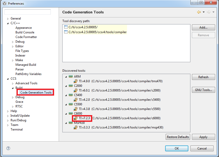

  • I cannot copy the screen window here. It displays:
    Code Generation Tools
    Tool discovery path:
    C:/Program Files/Texas Instruments/
    C:/Program Files/Texas Instruments/ccsv4/tools/compiler
    Discovered tools:
    ARM
    4.5.1 C:/Program Files/Texas Instruments/ccsv4/tools/compiler/TMS470
    C6000
    6.1.9 C:/Program Files/Texas Instruments/ccsv4/tools/compiler/c6000
  • Thanks. 6.1.9 is very old. Is there any chance you can move to a later version of the build tools? You can update your compiler version but still use you existing CCS version (even though I strongly recommend you update your CCS version too)
    http://processors.wiki.ti.com/index.php/Compiler_Installation_and_Selection#CCSv4
