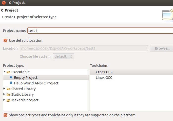

I new a arm project with the step below:
but  when I build the project,it print:
