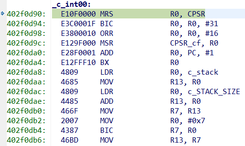

We are trying to make booting from an SPI Flash memory functional without the GEL file on DRA604. The project we are experimenting with was created as an empty C project in the CCSv5.5 with AM3359 selected as the target platform. The SPI did not work out-of-the-box so we are loading the executable into SRAM using a J-Link Base JTAG probe.
The problem seems to be that the default state of the Thumb bit in CPSR register is set to 1, while the first instruction of the resulting application is a 32-bit instruction (read of CPSR, see the attached disassembly screenshot). The code works properly when we manually change the Thumb bit to 0.
The compiler parameters set by the project are the following:
-mv7A8 --code_state=16 --abi=eabi -me --include_path="C:/ti/ccsv5/tools/compiler/arm_5.1.1/include" -g --define=am3359 --diag_warning=225 --display_error_number --diag_wrap=off
We tried both --code_state=16 and --code_state=32 with no luck.
Is there any way to change the default state of the Thumb bit, or is there an option to compile in a way that the CPSR read instruction would work under the Thumb mode ?

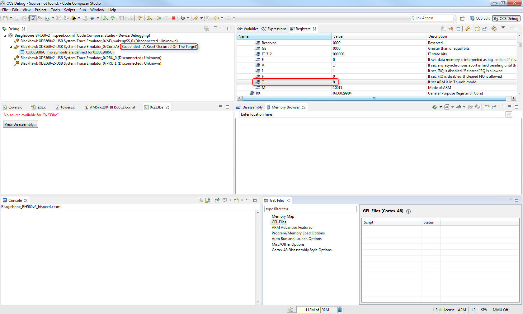

    - My previous knowledge from other projects is that the CortexA8 on the AM335x devices always boots in ARM mode - I can only assume the CFGTE signal is internally tied to "0" (check the screenshot below, with my BBone White immediately fresh from reset).
    Therefore, I find interesting your observation that the processor has the T bit set after reset - I wouldn't expect it so, but perhaps there is something else going on with the processor, or perhaps the type of reset applied is a "warm" reset that does not fully mimic its status as if it was coming from a power up. That also explains why resetting the T bit makes the code work - the first instructions of your screenshot are ARM.

    Thank you very much for your help, CFGTE signal seems to be the problem, however we are not able to find any documentation concerning its state in AM3359
    Both DRA604 and AM335X EVM have Thumb bit 1 after issuing reset.
    Thanks aswell for boot.asm location, we have found temporary workaround, since first arm instructions are only used to read CPSR and change the state of T-bit, we've commented them out, and app works straight away, only problem though is that rest of our binaries are build with 32 bit mode instructions.

    Today we have discovered interesting things
    with J-link Base:
    Thumb bit is initially 1, and stays 1 after reset
    with XDS200:
    Thumb bit is initially 0, and stays 0 after reset
    with XDS560:
    Thumb bit is initially 1, and gets changed to 0 after reset
    Hope this helps someone, however this does not specificly tell us, what is the default state of the Thumb bit.
