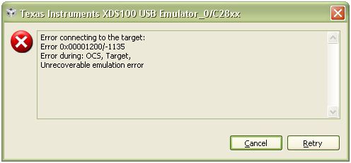

I've been debugging successfully a C2810 project board with CCS3.1 and a Blackhawk XDS510 for a few years. I just bought a Blackhawk XDS100v2 and downloaded + installed the free CCS4.1, apparently successfully. I imported my CCS3.1 project and can now compile it without errors on CCS4.1.However if I try to connect to my target board with the XDS100v2 I get this error message:
C28xx: Error connecting to the target: Error 0x00001200/-1135 Error during: OCS, Target,  Unrecoverable emulation error

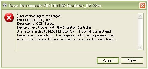

Retrying after this repeats this error message:
C28xx: Error connecting to the target: Error 0x00001200/-1041 Error during: OCS, Target,  Device driver: Problem with the Emulation Controller. It is recommended to RESET EMULATOR.  This will disconnect each  target from the emulator.  The targets should then be power cycled or hard reset followed by an emureset and reconnect to each target.
Resetting and cycling power does not help, I cannot get any further. I used DBGJTAG to test the JTAG link, and it looks OK.

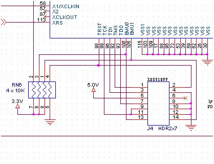

Also: I have to add a 8'' cable between the XDS100v2 and my project board to connect the 14-pin JTAG headers, because the XDS100v2 will not physically fir on my PCB. Could this extra length be problematic?

    My JTAG Hardware Konfiguration is as in the EDSP borad F2812. and I use the XDS100 from Olimex.

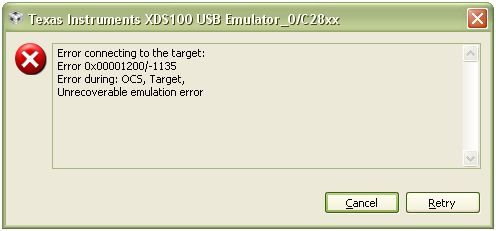

  • If I try to connect to the Target I receive this Error:
    I use  Code Composer Studio Version: 4.1.1.00014

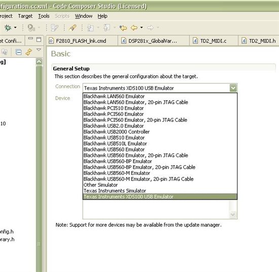

  • My complete message was cut while posted, so here it is in segments:
    (2nd error message after clicking "Retry")
       2. CCS Version: Version: 4.0.2.01003
       3. CCS Installation directory:
     c:\Program Files\Texas Instruments
       4. Setup Configuration .CCXML file for configuration being used (found in the "<user name>\user\CCSTargetConfigurations" directory):
    “Td-2.ccxml” file:

    I am trying to connect to an TMS320F2812 with an XDS100v2 emulator. After starting CCS v4.1.1, I click "debug" and I get:
    1.
      1. Screenshot of error message
        After clicking connect Target
    After clicking “Retry”
    1.

  • From the configuration information, it looks that you have a XDS100v1 emulator and have selected the XDS100v2 in CCS. We tried that configuration and updated the wiki article here: http://tiexpressdsp.com/index.php/XDS100#Q:_What_happens_when_I_plug_a_XDS100v1_into_a_card_but_select_an_XDS100v2_in_CCS.3F
    For this problem, we would like to also see the logs from: http://tiexpressdsp.com/index.php/Debugging_JTAG_Connectivity_Problems
    Also, do you have an Olimex XDS100v1 emulatior or Olimex XDS100v2 emulator? If you have a Olimex XDS100v1, then you need to select an XDS100v1 in the CCS emulator configuration.
  • Anadi, after looking through this, we think the problem is that an XDS100v1 has been selected in CCS emulator configuration when you actually have an XDS100v2. We updated the wiki here:
    http://tiexpressdsp.com/index.php/XDS100#Q:_What_happens_when_I_plug_a_XDS100v2_in_to_my_card_but_select_XDS100v1_or_XDS100_as_the_emulator.3F
    Thanks Steve,
    How do I select the Blackhawk XDS100v2? The only option I see in the "New Target Configuration" is for "Texas Instruments XDS100 USB Emulator", which is what I have used?
    The Update Manager lists one "Blackhawk CCSv4 Emulation (4.0.1.1)" update available, but gives this error message: "Blackhawk CCSv4 Emulation (4.0.1.1) requires feature "com.ti.ccstudio.product (4.0.2.00013)", or equivalent. " (I have  Version: 4.0.2.01003) and does not update.
  • Thank you stev for the Help,
    I have Olimex XDS100v2 emulator (with 20 pin JTAG and adapter kabel to the 14 pin JTAG) SO if  I read the WIKI it is a V2 Emulator.
    But I have tested it by selecting XDS100V1 in the configuration but still same eroors.

  • I have CCS v4.1 and it has XDS100v2 support. There is a drop down item there that shows "Texas Instruments XDS100v2 USB Emulator" in that version and newer. You should be able to download the latest CCS here: http://www.tiexpressdsp.com/index.php/Xds100#Installation_for_Code_Composer_Studio_v4.1
  • All the tests should be done with the emulator plugged into the target and PC. If the later tests were done with the emulator plugged in, the problem is with the target card connection to the JTAG header. SC_ERR_PATH_BROKEN means that the JTAG scan chain is broken from the connector to the target device. You may want to check the electrical connections.
    Is the Olimex unit you are using this one: http://www.olimex.com/dev/tms320-jtag-usb.html ? If yes, this is an XDS100v1.
  • Dear Steve,
    I downloaded CCS4 4.1.1 and this did the trick: I can now connect to the XDS100v2 and debug. Thanks for your support...

  • Even after selecting XDS100 V2, i am facing same props:
