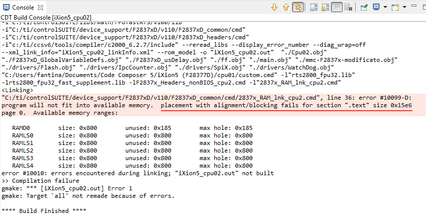

I compile it and I obtain this error
".text" size is 0x15e6 ( about 5.6kword )

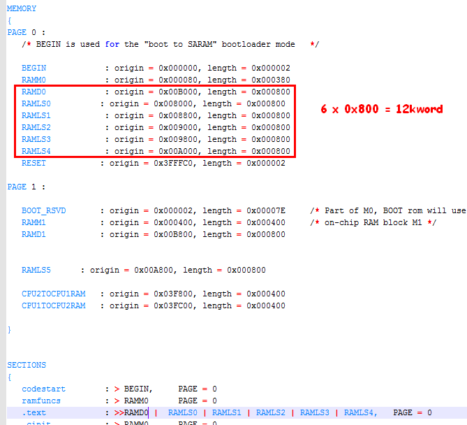

but in the linker script I supply about 12kword in more split sections

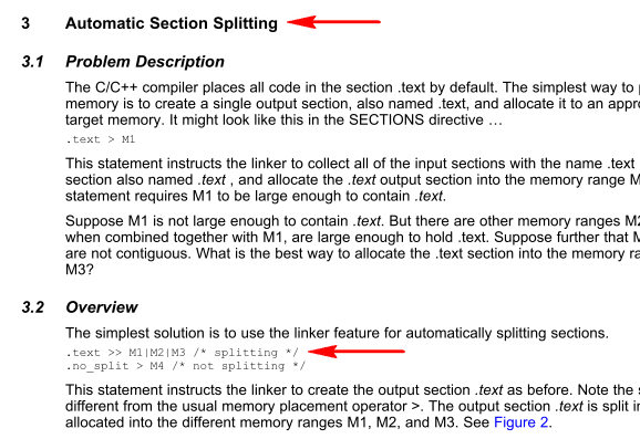

Split sections is described at page 4 of spraa46a
