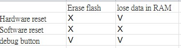

    (1)Reset will not erase flash and debug button will ? If i modify register in LDC1000 sensor which connect to launchpad after press debug button first ,
         which one should i press(reset or debug)?
        I don't know what's the occasion should i press the button of them. could you give my a example?
    (2) What's the difference between hard reset and debug? Is hard reset and debug are the same?

  • Hi Leo,
    Yes
    Again hard reset will not erase the flash but re-run the code but debug will erase as well as later program and then wait for you to re-run.
    Gautam
  • Hi Lee,
    I just want to add to what Gautam had said
    1. In general context of a RESET it will never erase flash, but for RESET button in ccs there're options where we can make the program to reload after a RESET, reload will erase flash. Similarly, for DEBUG button in general context, it will clear all the flash and program it, but there're options in CCS by setting which you'll not clear the flash or program it (you can find how to set those options in this link processors.wiki.ti.com/.../MSP430_-_Connecting_to_a_running_target )
    2. Hard resets are resets due to power-on event, you'll loose all the data in RAM and it will initialized to the default values but in case of software reset you'll not loose the RAM contents unless it's intentionally cleared. As mentioned in above point Debug button in general context will clear all the flash and program it. Hard reset is a hardware phenomenon, where as Debug is a button in CCS.
