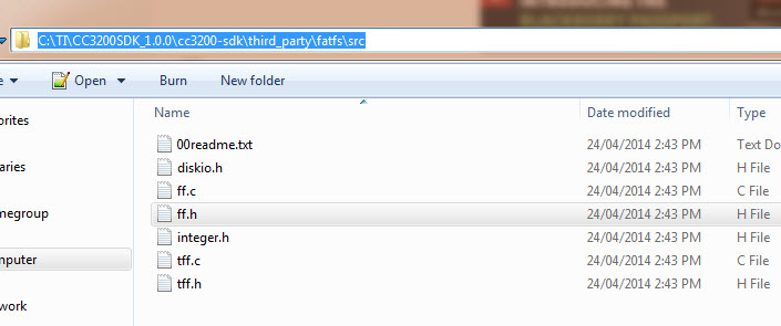

I'm trying to integrate the SD card functionality into a project but I am getting this error “#1965 cannot open source file "ff.h"”.  The fatfs library folder is added to the path, and in fact I can see the folder and ff.h file in the Includes group of the project in CCS.  But the compiler keeps giving this error.  I've tried  restarting CCS, cleaning the project, changing the search order, using absolute paths, etc. but nothing gets rid of this error, so it doesn't compile.

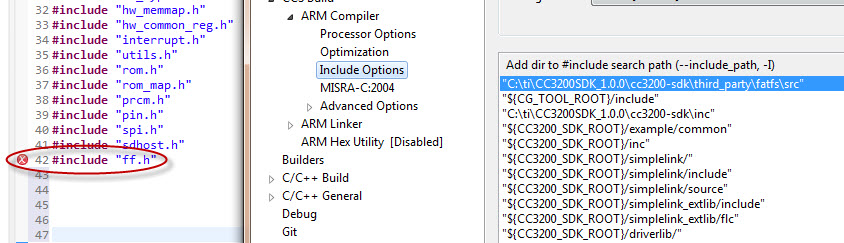

    Does the compiler's include path point to the exact directory where ff.h is located? Please show a screenshot of the compiler include paths as specified in CCS, and also the build error as it appears in the CCS build console (you can copy and paste the entire contents of the build console to a text file and attach it here).

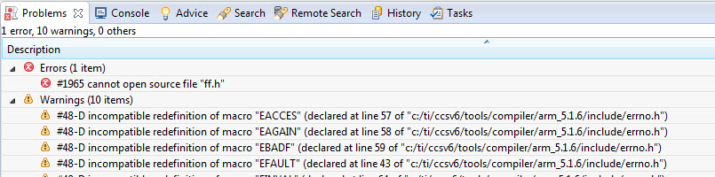

  • Sorry I had pasted a screenshot in the post but it didn't stick apparently.  I'm attaching images.  The build console shows:  fatal error #1965: cannot open source file "ff.h"
  • The include path looks ok so I'm not quite sure why it is giving the error. Can you still generate the build log from the CCS build console (not the Problems view) and attach it here? You can generate the log using the icon shown below.

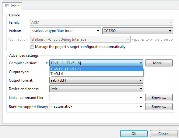

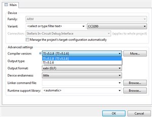

    I noticed that there was this warning (which interestingly doesn't seem to appear in the build log):
    This project was created using a version of compiler that is not currently installed: 5.1.8 [ARM]. Another version of the compiler will be used during build: 5.1.6. Please go to <a href="liveaction:OpenAppCenter">CCS App Center</a> to install the compiler of the required version, or migrate the project to one of the available compiler versions by adjusting project properties.
    In the CCS General settings the compiler version shows TI v5.1.8 version selected but apparently this version isn't installed. I'm not sure how this happened since I just installed the latest CSS available and didn't change this setting.  I noticed this warning before but didn't suspect it was related, since the warning indicates it was using v5.1.6 anyway.  I tried to change it to v5.1.6 explicitly and this made the problem go away.  Now the console log shows the additional include path added to the compile command.
    That is odd that simply setting the compiler version to 5.1.6 explicitly (when it was using that version for the build anyway) made the error go away. In any case, I am glad the issue is resolved. Thank you for the update.
