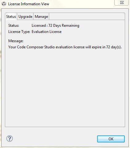

  I have downloaded & installed CCS V6  6.0.1.00040 under  windows XP very recently using  CCS V6 OFFLINE installer    package.
  After installation It didn't prompt for licence activation.It was shown as Free Licence.Then I removed the free licence location  by going thru'  Help --> Code Composer studio Licencing Information . And became Evaluation Licence as shown in the  licencing information.
I was able to compile  & debug a test code of size more than 30K approx.

  • Hi Gautam,
    Thanks . But my doubt remains same. I have already seen "License Information View" and from that only I saw the Evaluation version status of 90 days Remaining " there which i had shared in my last post.
    I am using  MSP-FET430UIF .
    My doubt is how could it automatically show "90 Days evaluation " Licence.I have not installed/activate  any evaluation licence file for CCS V6 so far. Only has CCS v5 running that too in other directory. Does the Offline software installer package comes with a "90 Days evaluation Licence" ?
    As i am not facing any problem, i am not much worried. If I assume that it took internally CCS V5 license file , will it going to affect the CCS V6 performance , any new feature (if any ) ...... I would like to know all .
    This should not happen automatically. User gets an option to select the license after installation of CCS. Can you elaborate on this statement of yours <"Then I removed the free licence location  by going thru'  Help --> Code Composer studio Licensing Information .">
    This would've not happened... if that would've been the case then Number of days remaining would've been very less and not 90days. This 90 days evaluation license is for complete feature set  and there will be no limitations until then. Also, CCSv6 license file is valid for CCSv5 but not the other way round!
