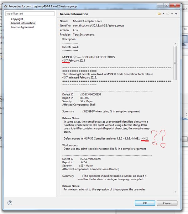

Ti msp430 compiler 4.3.7, are we going backwards ?
I just got a recent compiler update in my CCS for the TI compiler 4.3.7 which apparently corrects bug in the version 4.4.2 ???
I am a bit lost here ....

    1) Do I have to conclude that 'cgt' is a different branch of the compiler ?
    2) which branch should I use ? (I am currently running 4.4.3 'cgt')
    3) what is the difference between the two branches ?
    4) www.ti.com.cn/.../slau132j.pdf is about the compiler v4.4 . Does that mean that the cgt branch is the right one ?
  • To start with, please see this wiki article to understand the differences between versions of the compiler.
    No.  The "ti-cgt-" prefix was added to the directories for those who install the compiler outside of CCS.  This prefix makes it more clear what the directory contains.  "cgt" stands for code generation tools.
    You should probably stay with 4.4.3.  The trade-off is between stability and new features.  In this case, the 4.3.x release stream has been in the field longer than 4.4.x, and thus is more stable.  So, if you don't need any of the new features that 4.4.x provides which 4.3.x does not, you may prefer to use 4.3.x.  All other things being equal, you want the last digit in the version number to be as high as possible.
    It only means that book describes the 4.4.x releases.

  • Thanks,
    In between I read the documentation (wiki) about the version number of the compilers and with your answer it makes more sense. I will stick on the branch 4.4.x then.
