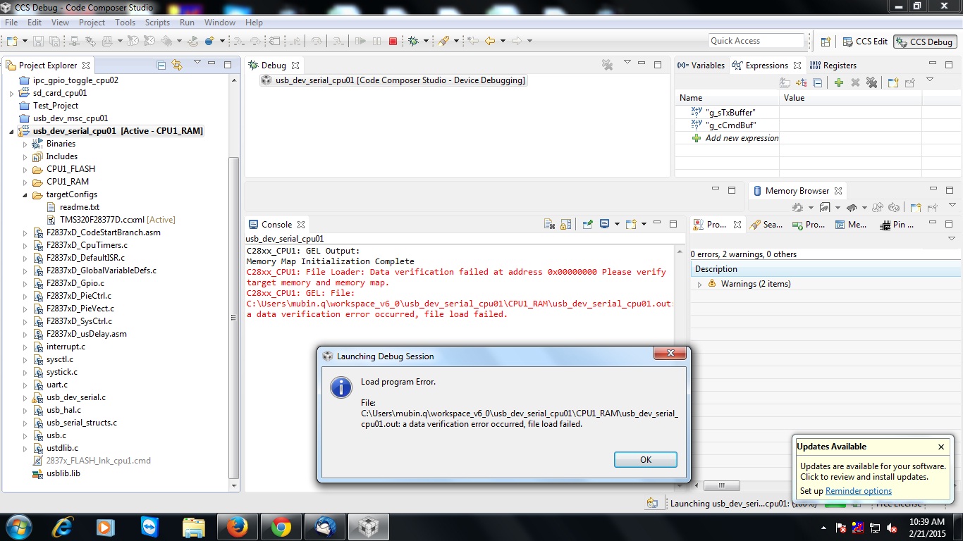

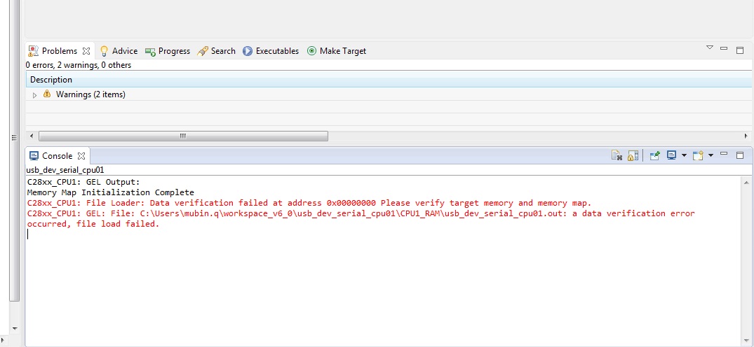

I am facing the problem while debugging the code.
I am using F28377D controller. Previously it is working properly.
PFA.

Yes, it loads fine for me.
Can you try this ccxml file?
https://e2e.ti.com/cfs-file/__key/communityserver-discussions-components-files/81/F2837xD.ccxml
ki
Hi Mubin,
Sorry for the delay in response. I don't know what the cause of the issue is. Your program is fine since I can load it with no trouble. You used my ccxml file which works for me but it did not work for you. Your basic JTAG connection is fine. Since this used to work, something may have happened to your board. Can you try using a different project from controlSUITE. Perhaps the blinky project in the first lab of the 28377D workshop here. See if you can get that project to load. That is supposed to work out of the box.
