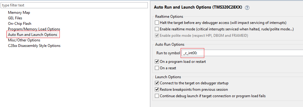

  • Hii Ki,
    Setting the entry point to [ _c_int00] in place of [main], but not proceed to next step i.e auto-run.
    The Error shows:- C28xx: AutoRun: Target not run as the symbol "_c_int00:" is not defined
  • yes this is expected because in this case, you are supposed to disable the "On program load or reset" checkbox (or leave the auto-run field blank). The debugger sets the program counter to _c_int00 on its own. The auto-run is to run to a label AFTER _c_int00. Since you are already at _c_int00, enabling auto-run to _c_int00 will run the program and give you the message you saw because it cannot reach _c_int00 after that point.
    Basically disable auto-run.
