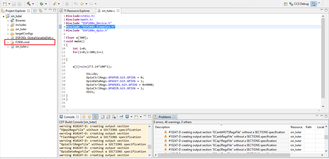

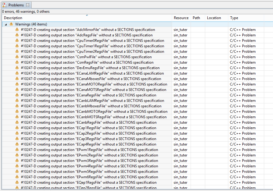

Attaching a photo copy of C code, on that some Unresolved Symbol error present. I am not getting Why & How solved that error.
Asim,
There is a response to the same question in this thread. As suggested by Ki and Gautam, take a look at one of the TI provided examples as there are some core set of source file that need to part of the project to avoid these "undefined symbol" errors. One such file is the "GlobalVariableDefs.c" file, but there may be others required as well depending in your code.
asim kumar dey said:Is required to import an example code for executing as per requirement?
You need to follow a certain structure. The above issues seem to occur due to invalid or no cmd (linker) file.
Please import examples from F2808 header/peripheral files to understand the structure. You can find the same here:
